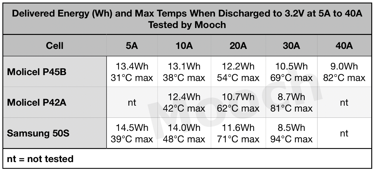

3 hours ago, Micharider said:
Question:
Assuming a technical, low speed trail riding setting, is there any sense limiting the power?
After all you use the throttle to define how much power you need.
Say 99% of the time the requested power is up to 50HP, but in the remaining 1% it would be nice to have the 60HP available.
The range gained by limiting the bike to 50HP in that case is negligible, isn't it?
When it comes to batteries the load reduces the capacity, quite drastically if I may add. In other words if you limit the power used you will automatically increase the range and its not not linear, its slightly exponential as more is lost to heat. That said if you are very good at limiting throttle it doesnt matter but I know from experience on my smaller bike I get the same range(~20miles) with 4.9kwh battery at 11kw of power as I do on 3.6kwh pack at 8kw or 30-35miles on 3.6kwh at 6kwh. Some of these are different conditions and different trails so take info with grain of salt as my bike relatively low powered so I tend to be full throttle alot and just carry momentum alot where a stark would do more on-off throttle.
Here are the popular high power cells test data(most people assume the Stark is using the P42A referenced here). You can see how the Wh decreases with power usage which Wh is simply how much range you have. Where when any mfg quotes wh it testing at 0.2C or about 0.8-1A discharge. That means if the stark is 6.5Kwh nominal and it peaks at 30A continuous(think just doing a top speed run until dead) then that pack is only going to have about 4.35kwh of actual useable energy but keeping it at 10A bumps that up to 6.2kwh. 30A would be 72hp and 10A would be 24hp roughly
Edited by mr.skywalker
  • Like 1
  • Helpful 3
It absolutely is, cost and availability is only problem, $4.5/cell vs $7.5/cell in bulk(over 1000cells), $6 vs $10 for small quantities. The samsung 50s is what Im looking at for next builds as I dont need high power put it falls in between both on price but kills them in range. Both of the last batteries have used P42A bc performance vs cost cant be touched. The tesla cells I used previously are pretty pathetic in comparison but they $3.25/cell
This is my last build with the P42A, a mini stark lol My battery quality has improved a good bit to say the least and this is pushing 14.4kw/18hp peak. Debated going with smaller pack with the P45B(100 cells vs 120 with P42A) but just couldnt justify it even with a little weight savings(about 4lbs difference) and better fitment
