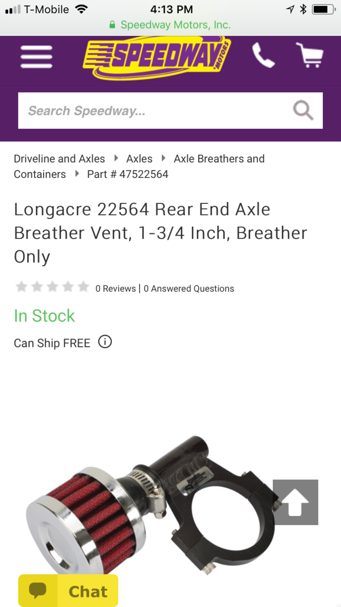

I have a 2016 ttr110.  I bought the after market air filter that Yamaha sells along with the jet kit.  I took the air filter box off and took the vacuum line back and zip tied it to the frame and put a little filter on it.  I’m in MN and the bike came with a stock 92 main I think and I had to go to a 78 main cause it was spitting fuel out of the air filter.  I also put a fmf power core 4 exhaust and big bars.
