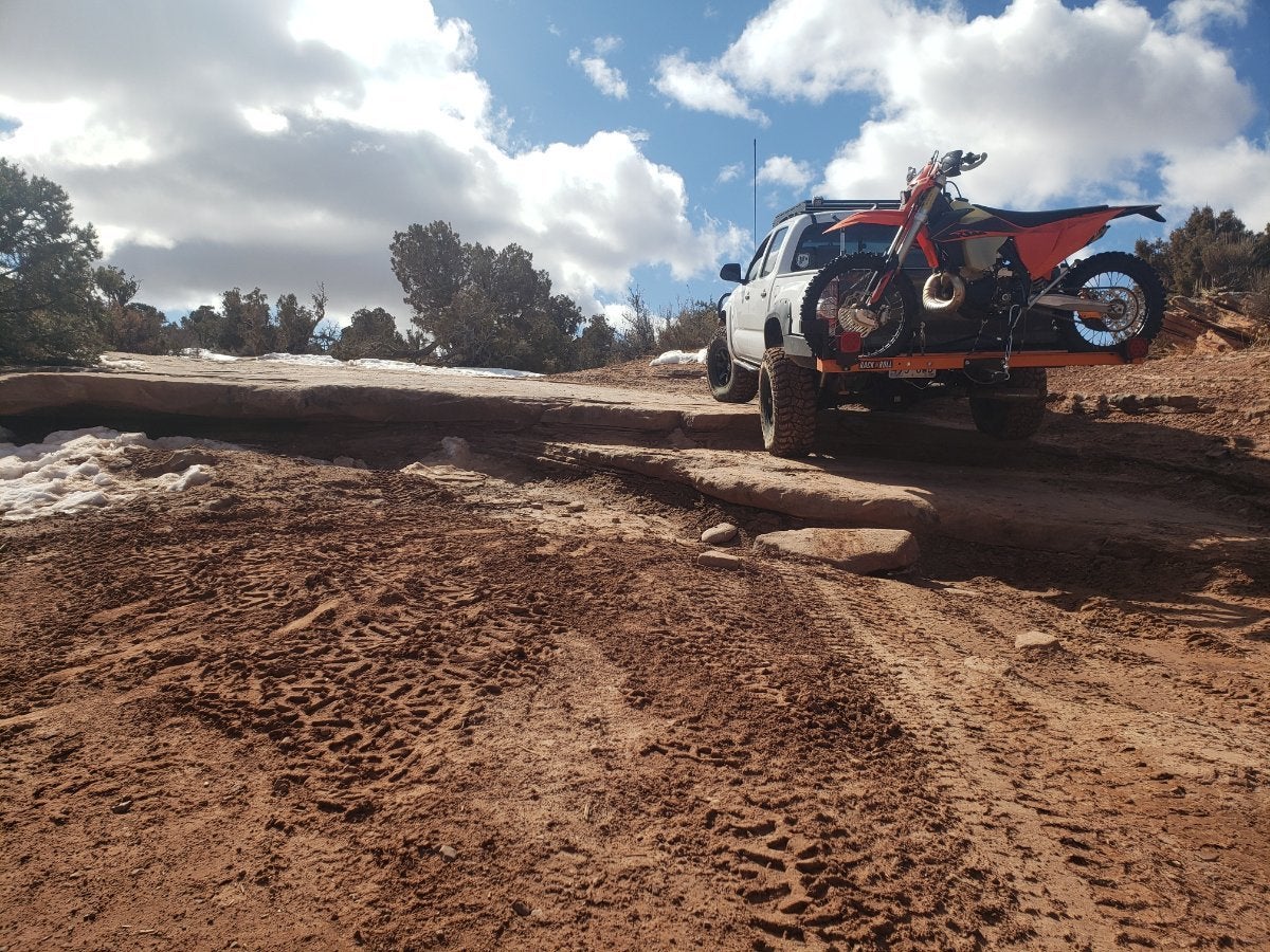

If you just take a moment longer, you'd notice, e.g., how your peg-securing tie downs on the hitch hauler in the photo you posted above illustrate the principle I'm simply pointing out. The peg-securing tie-downs are behind the fork line.
