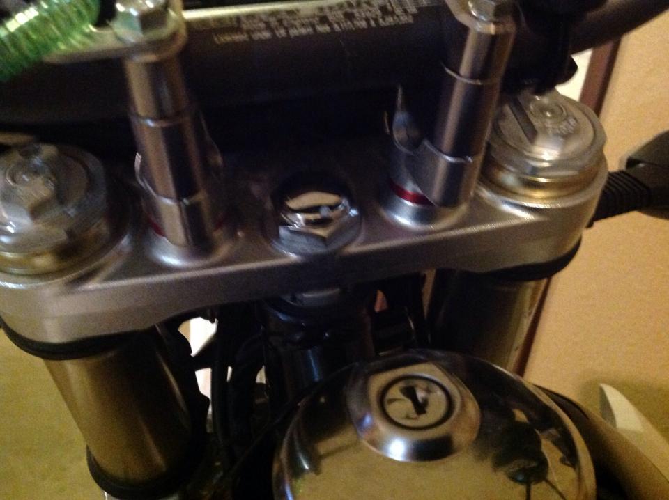

The advantages are a more direct "feel" with your bike. Yes you do feel more vibrations with them but totally illimates bars twisting inside your triple tree. My bike was one day old and my son dropped it going approx 10 mph in grass and for the longest I thought my bars were bent but in fact they were not. They had twisted inside the rubber mounts. Yes you use your stock bolts with the rubber killers but I do not know what the recommended torque is on them. Would I do it again ... Yes I would and recommend it. See pics. They are red anodizedimage.jpgimage.jpg. I even added zeta 30 mm bar risers to mine. Makes for a more comfortable riding position

I have the protaper bar mounts and zeta rubber killers on my bike... The protaper bolt is indeed larger so I used the stock bolts, 4K miles and never had a problem.
