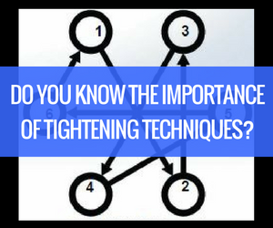

How A Clamped Joint Works
I’m going to discuss the importance of criss-cross patterns, tightening sequences, incremental steps, and joint lubrication but first I want to explain how a bolted joint works. As a bolt is tightened to secure a pair of parts, the bolt will stretch a very small amount. The stretch in the bolt creates tension or preload in the joint which is the force that keeps the joint together. The amount of preload created is dependent on bolt size, bolt material, the torque applied, and the friction between the threads. There are additional variables, however a discussion on bolt engineering would be very long and not all that exciting! As long as you understand the basics for engine building you can begin to appreciate the importance of correctly tightening fasteners.
As you are well aware, an engine consists of many parts fastened together. What you may not consider as much is that the majority of these parts are fastened by more than one fastener. This means that how much you tighten/preload one fastener will have an effect on the surrounding fasteners. This interaction between the fasteners begins to shed light on why tightening sequences are so important.
The evenness of the preload across the bolts securing a part can affect part life. Warpage can occur in parts which are improperly tightened, ultimately rendering the part useless. A prime example of a part that can warp is a four-stroke cylinder head. If the bolts are unevenly tightened over time, the cylinder head can become permanently distorted. Gasket sealing problems can also occur from improper preloading of bolts across a part. In order for a gasket to seal it must be evenly compressed. If one area of a gasket is highly compressed and tensioned while another area is not, the gasket can easily leak through the low tensioned area. In the case of plain bearing bores, such as the cam cap, uneven preloading may cause the bearing bore to distort. As a result the cam may become difficult to turn. Or if run, the cam bearing bore will wear unevenly and in severe cases the cam could seize.
While ensuring bolt preload is even can be a problem there are three tightening techniques that virtually eliminate the issue. If you’ve been building engines for any length of time you’ve probably already been utilizing these techniques. Hopefully now you may have a better understanding of why the service manual instructs you to tighten parts a specific way.
Criss-Cross Patterns
Criss-cross patterns are called out when tightening or loosening parts with a simple square pattern or circular bolt pattern. These basic patterns have been around for a very long time and are a proven method for evenly distributing clamping load across a part. Most cylinder heads will utilize this type of clamping pattern.
