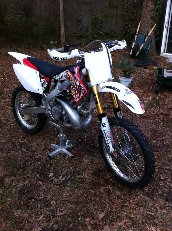

Who makes the cleanest conversion using the latest 250F chasis with the Yz 250 2-stroke motor? I want to build a killer like this with a gorr 295 kit and revalved SSS kyb suspension for scrambles racing.

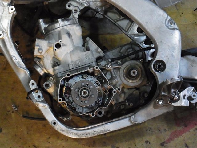

I don't know it will be the cleanest conversion or not, I just started it now.
I've already got the latest 250F chasis and the Yz 250 2-stroke motor with EG295 kit.
And I'm grinding its lower engine mount to decide the 2-stroke motor alignment.
Next, the thing that I should do is to solve a lower frame issue that is the maximum problem on this plan.
I've arranged to get an used 2-stroke frame for it, and i'm waitig for its arrival.

How did you decide the engine alignment? It's important for the movement of a rear suspension as you know.
I copied the position of the counter shaft , a swing arm pivot, and a rear axle shaft from YZ-F.
And, I'm adjusting it now.

The YZ frame as victim finally arrived in my garage yesterday. It spent about three weeks by so lazy USPS and JPO.
At first, I'll make some jigs with this frame. Afterwards, a necessary part will be cut out from it.
I plan to start those works next week.

I confirmed the problem while waiting for arrval of the YZ frame. I'm thinking which radiator of YZF and YZ to customize.
And, I'm thinking about how to make under pipes of frame.
If I don't mind about the much clearance with the engine, it doesn't have the problem like YZF either.
However, I want to ensure ground clearance as possible, I'm going to re-create that part.
If it is possible, could you show me some pics of the part of your frame? It would be very helpful reference for me.
To complete this plan, I should solve various problems besides.
If someone want to put 2stroke motor in YZF frame, I would strongly recommend to buy a complete frame from MPS.
They seem to have enough experience and skills for this work.
Though it is interesting for me to solve various problems by myself, but I'm nuts to do the same work with the pay for their work.

I went a different route on my AF. This started as an 04 CRF250 that I put a very modified CR500 in. Got to ride it once then the kick mechanism failed and busted out the center and primary cases. I had this spare YZ motor in another chassis (1st gen CR250 chassis Motard) and dropped it in. It was a little harder in some things especially getting the air boot to clear the shock spring but I finally got it. I found the ultra rare aluminum pipe on flea bay and the Ohlins on Craigslist. It sports a Rad Valve, milled head and a 9 oz flywheel. Only got to ride it once but hopefully I can get it out soon. The 500 had an aluminum fuel tank I made also. It handles well and turns better than my 01 YZ250. BTW, I snagged an 05 YZ250 frame off flea bay and will start putting my 01 stuff on it. :goofy:
