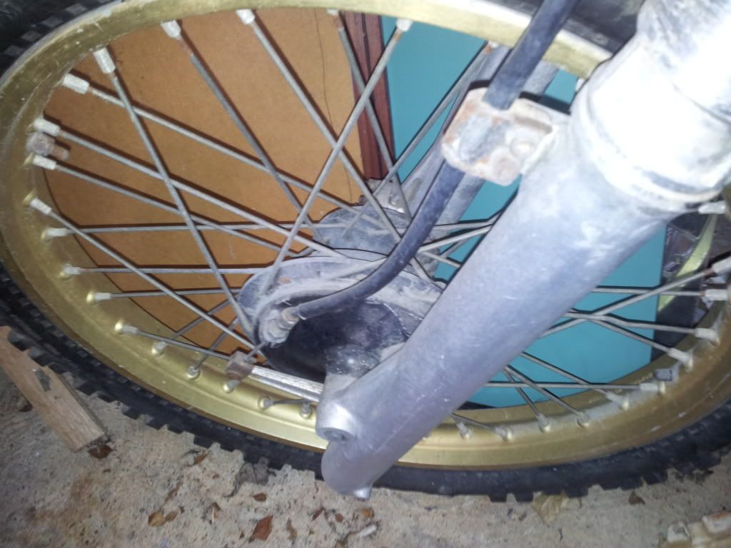

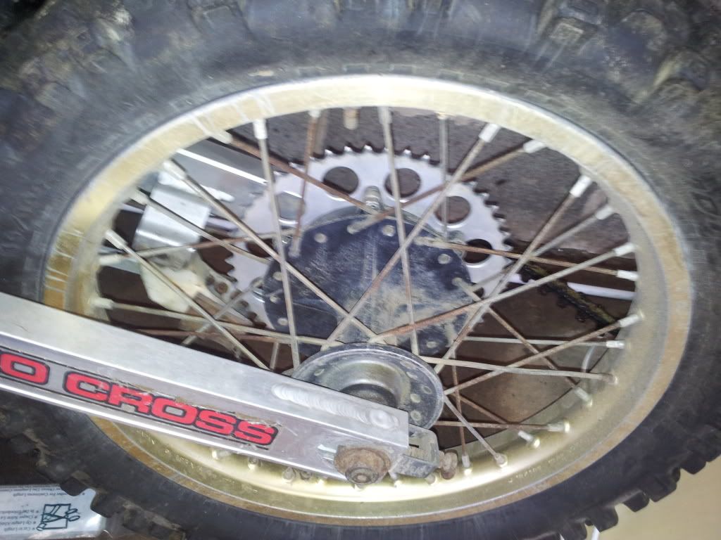

My dad bought this bike for £90 back in 1998 with a blown top end
It sat at the back of his garage for about 8 years until he passed it onto me after a few beers together in a bar, since then it has been sat in my garage for about 4 years. It has been on my mind alot recently and ive decided im going to keep this bike for as long as i can, so eventually it will be getting restored to it's former glory. Cosmetically the bike is in rough shape, but thats easily sorted. Mechanically the bike is a good starting point for an easy resto, i think at least.
The wheels and hubs are in fairly good condition, these will be getting rebuilt, repainted and re-anodised
  • ikis86
Posted 02 August 2012 - 05:32 AM
This will not be an original restoration, so im not bothered about having aftermarket plastics/handlebars etc. but i want to keep it looking as close to factory as possible.
It does have a fresh top end, however i will be splitting the cases and replacing every bearing and seal
Unfortunately some of the powervalve appears to be missing, lost in the moving around its done over the years.
Does anyone know if this old YZ had 'Z' spokes? i've heard they can be tricky/expensive to get hold of. Also what year YZ's had the early rotating drum powervalve? Right now this is just a daydream project, sourcing parts and information before i tear into it. I know i will be putting more money into it than it will be worth but i'm doing it for the love, me being 26 years old this old bike is the start of the first true MX bikes in my opinion, i'd love to sit and stare at it when its finished, not just ride it!

  • ickfinger
Posted 05 August 2012 - 06:36 AM
As far as "z" spokes go, no, your bike doesnt have them.  They go from one side of the rim all the way to the opposite side, zig-zagging thru the hub.
