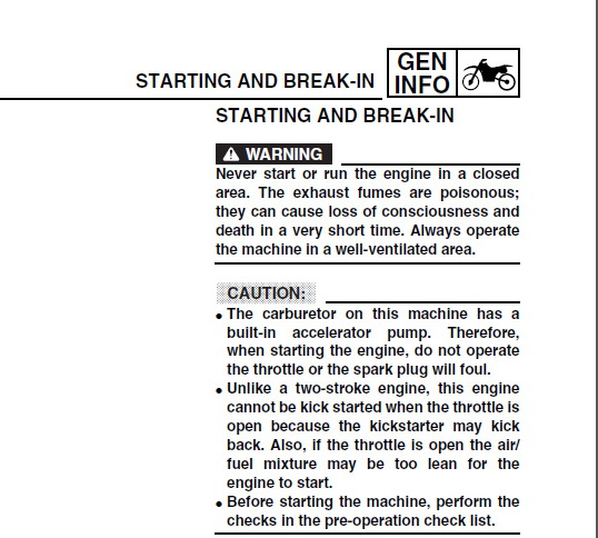

Those habits are so troublesome that Yamaha saw fit to add a bit about it in the WR450 manual:
Habits are hard to break, and I had the kickstarter broken off of one of my WR450s by a long time two-stroke rider who wouldn't follow the four-stroke starting drill...
He kept opening the throttle despite repeated instructions not to and sure enough eventually it kicked back and there went the kickstart shaft.
