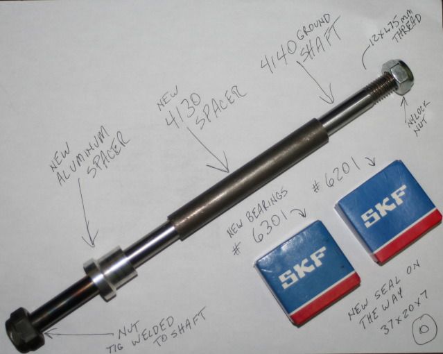

This just got more fun , My rear axle is seized in and I've now destroyed it trying to take it out . and it's still stuck in ??  There are none on e-bay so I'm guessing this is common ?

I never had a problem with the rear axle, but the front on the other hand... It didn't seem "normal" when we needed to change the tire the first time. I must have spent 15 minutes twisting that thing with a wrench and alternately pounding on it with a hammer. When I got it out, it was a gentle "Z" shape. I ended up replacing it with another long 10mm bolt - an engine mounting bolt for a street bike. Took all the abuse we could throw at it till we swapped in the KX100 front end. It's currently taking abuse on my minGP bike. Suzuki should have used a 12mm bolt like Honda does on the XR100.
I don't remember what size the rear is, but I bet if you can find another bolt the same length and diameter, I bet you'll be fine. Now if it was an MX bike, I'd say buy a replacement from Suzuki.

I think not much short of a chainsaw is going to get it out of there. Maybe I'll go gentle and use a saws all .

Pop the forks out, take one side and the wheel off, then go to town on the bolt and if you have to, press/drill it out. That should minimize the amount of damage the sawzall does.
ETA: I'm an idiot - forgot this was the swingarm. Sawzall it is.

Do your best not to damage the hub,klx rear hubs are not easy to find used and i had one on backorder for two years the never showed.

I got it out last nigh with a combination of impact gun on one end and a big hammer on the other . The axle was very rusty and bent on the sprocket side. Serious junk part I think. The Hub looked good and the bearings came out just fine with some light pounding
Here was todays fix for Suzuki's junk DRZ125 rear axle parts .
A one foot long piece of 12mm 4140 cromoly ground shafting.
Some new SKF bearings made in Italy as opposed to that other place the bearings come from.
and some new spacers made of some better materials.
Now if I wouldn't have bought that brand new Pirelli Diablo in a 14" I would have been able to just toss the whole stock swing arm and wheel in the trash and start over with my KX100 swinger and 17" rim  :thumbsup:
