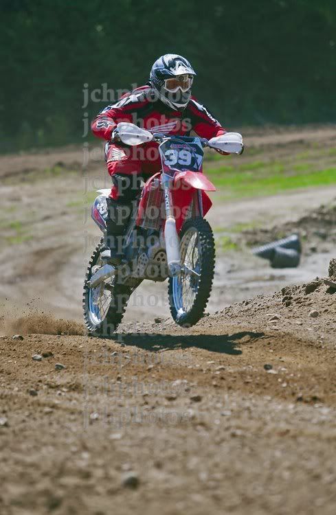

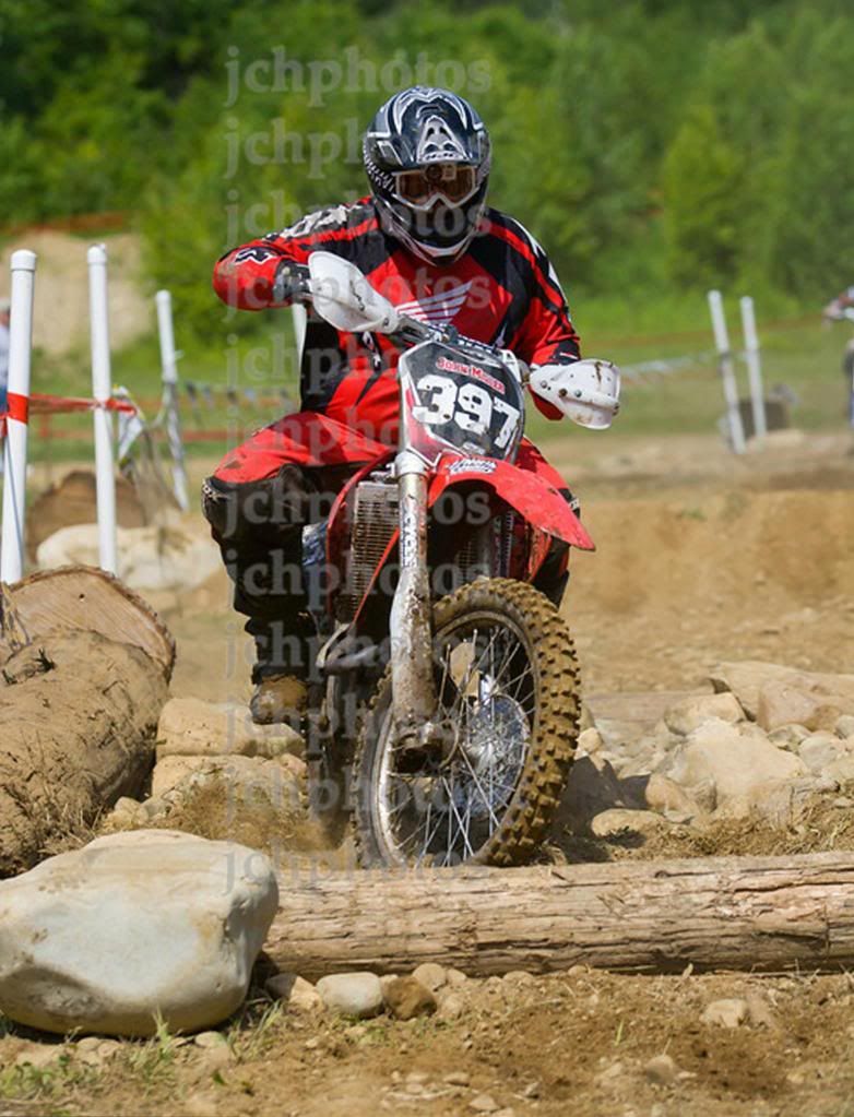

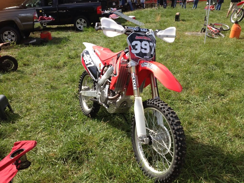

Just ticked over 40hrs on this bike. I am a slow, fat, vet rider and it's a reliable trustworthy bike for the harescrambles, gp's, and moto practice I use it for. It starts easily, handles great, has plenty of bottom for tight woods, doesn't overheat, and will be in my stable for a few years for sure. Revalved for woods it surely is a great starting point for a bike you can do anything on. No problems what so ever. I'll be changing my fuel filter this week and checking my valves again. (20 hrs no movement since out of the crate). First 2 oil changes were done at 1 and 5 hrs with Honda GN4. Next 2 oil changes were done with Honda HP4 semi syn. Now I've stretched my intervals out to 8 hours on Honda HP4S syn. I really appreciate having seperate engine/trans oil. Straight GN4 in the trans changed every 15ish hours.
Mods:
Cycra CRM handguards
Trailtech hour/revmeter with works connection fuel tank mount
Devol rad guards with braces
Works connection extended coverage skid plate.
CCycle woods revalve for my 245 fluffy frame.
