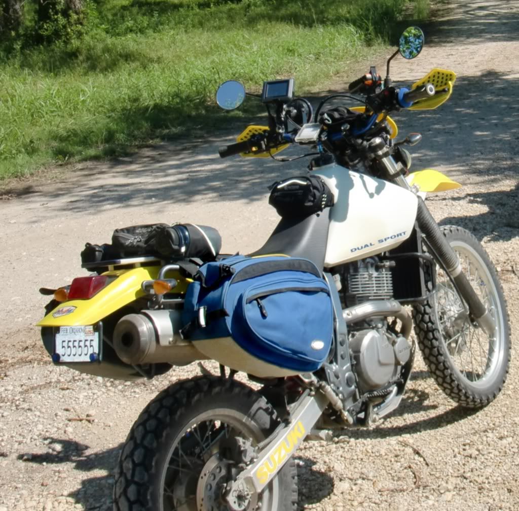

The Clarke tank should fit just like the original steel tank using the original rubber mounts on the frame.  If the tank is too wide, there is a problem with the tank.  I'm not sure how it could be too wide.  Are you sure it is for a DR650?  Should look like this:
