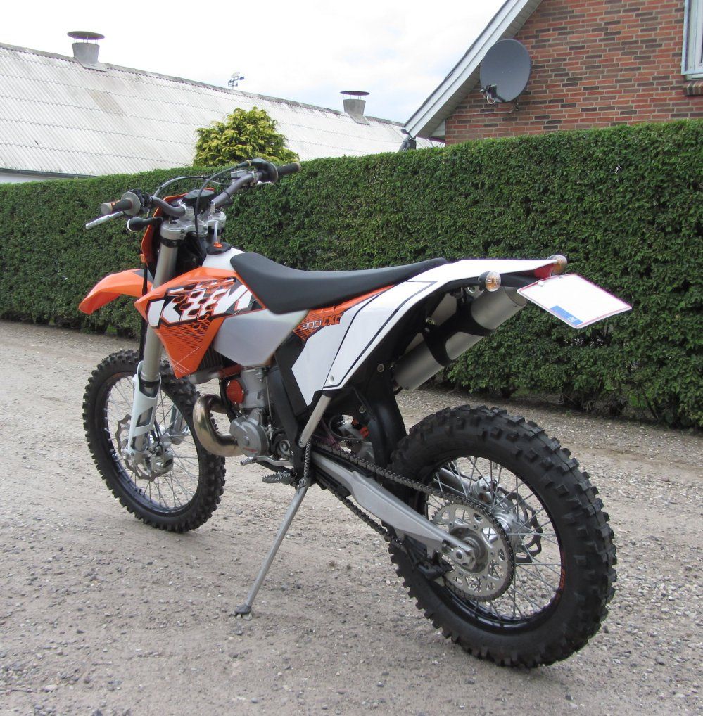

I have removed my e-start, on my 2011 - 300 EXC:
The speedo... Could be the sensor, or the magnet that's missing. Easy fix.

woaw Psyquan thats a nice bike! You should take it some offroad
