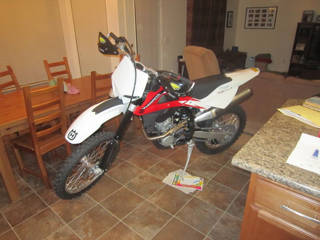

Setting it up for the first ride (First and last time it gets to go inside the house, it was to hot to work on it in the garage)
On the truck for the break in ride.
Great looking bike!

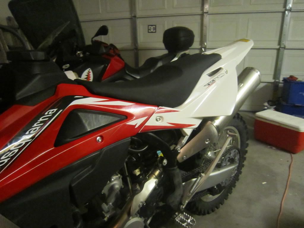

Posted 20 June 2012 - 05:29 AM
Newest modification lowered seat hight to 36.25"
Tuned out well for "Do it yourself"
