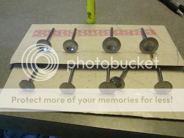

I have tested this myself.. I had some OEM valves coated with chromium nitride CrN. Running on copper seats, they did 100hrs and never once shifted clearances... perfectly reliable..
The difficulty, is stripping the crappy OEM coating back to bare titanium.. Trying to chemically remove it, leaves the chances of pitting the surface.. some were useable, so not so.. I had to polish the stems with diamond polishing paste..
heres a pic
