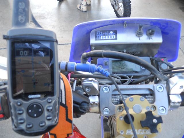

  • dustdogg
Posted 11 July 2012 - 06:02 PM
Check out www.airtime-hid.com
I am running this on my WR 450 and it is sweet!!!  It has hi and low switching that can each be turned on seperately or together if your bike is capable of powering it.  On the CRF 250X you will need to look to Baja Designs or Ricky Stator for stator upgrades, but once you go with the HID you will wonder how you ever rode without it.
