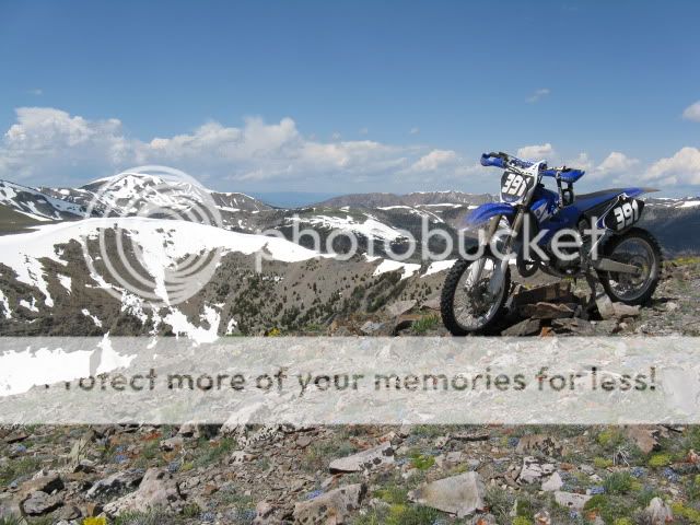

When im riding mine I find that i cant let off. Cant loose momentum! Stay on the gas, wheelie/ Jump anything you can! Pic is an absolutely stock bike @11k In Idaho.
