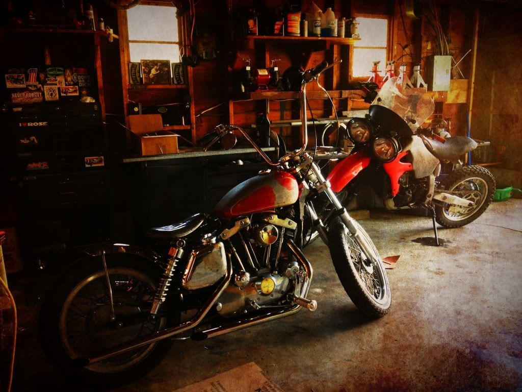

Oh and here is the pig:

sorry, i can't help with your issue, but that is one interesting 650r. haha

sorry, it may not be to everyone's likes, and I didn't buy it new, it came funky :cry:
