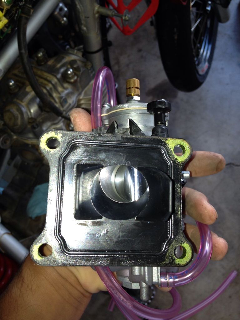

Posted 08 June 2012 - 11:52 AM

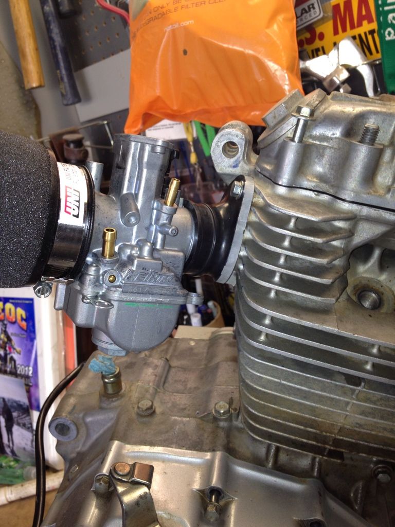

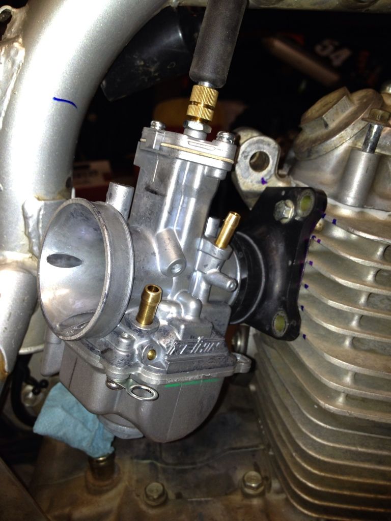

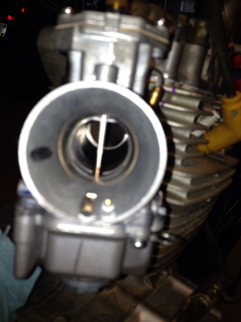

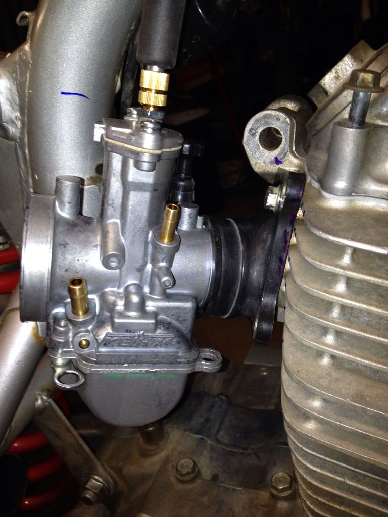

Ok here's what I ended up doing.

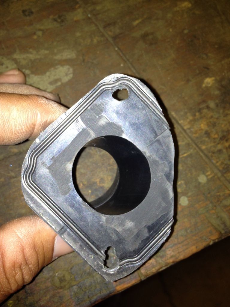

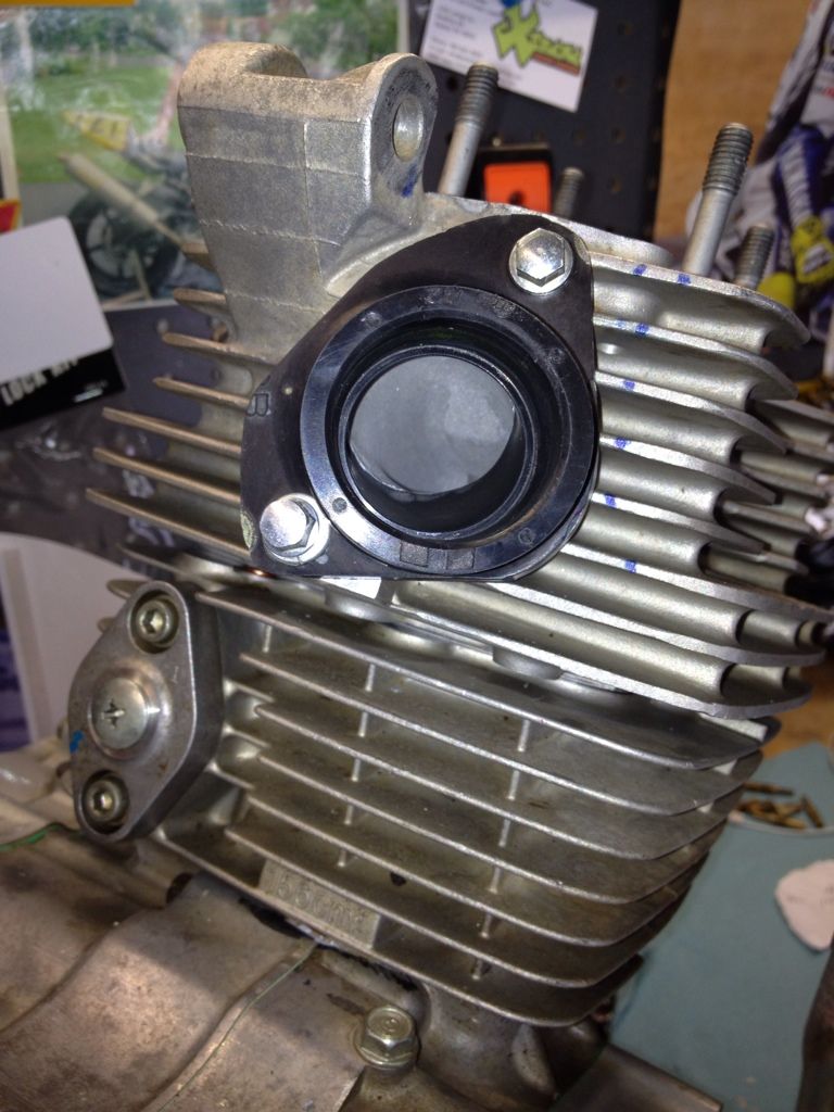

I used a RM 85 intake since it has the same size intake for the carb.
Flipped it upside down so the carb will still be in an up right position.
Cut off the excess meat that I don't need and drilled new mounting holes to mount to the motor.
Intake was a little larger than the intake on the head so I got it Ported.
Big thanks to MBR, Mad Brothers Racing.com for the port and polish job!!
I'm still waiting for the new cam to come in to put it all back together, then need to screw around with jetting.
RM 85 intake.
CR, KX, YZ should all be the same.
Cut off excess and drilled new mounting holes.
Need to port
Ported
Just about done, just waiting for new Cam.
Edited by Defran, 09 June 2012 - 12:23 AM.
