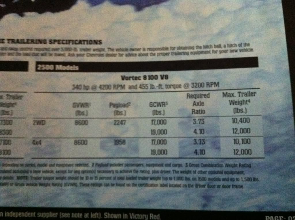

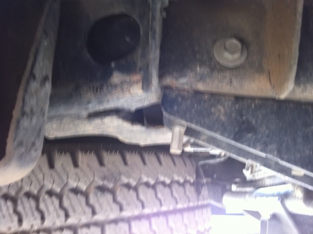

  • BMRFlagstaff
Posted 04 June 2012 - 08:31 AM
dezracerE, on 26 May 2012 - 03:16 PM, said:
That is one way to take up the weight.
I have seen several Chevy truck frames bow from the load eq hitches and excessive tongue weight.
My buds 30' Weekend Warrior fully loaded has about 1000 on the tongue. It bows the truck like a banana upwards. Kinda crazy.

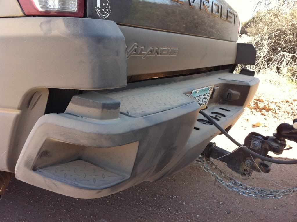

  • BMRFlagstaff
Posted 06 June 2012 - 09:38 AM
SAPPERS, on 04 June 2012 - 09:12 AM, said:
uhhh, that's what happens when a class V piece gets hooked to a class 3 hitch.
That is what you would think, we pull a 7000-8000# trailer with about 900# tongue weight.  The manual states the 2500 Avalanche can run 1500# tongue weight, also spec'd at 10,100 total with wd hitch.  My bad to believe what I read.  Threw enough metal on that to fix it that Posted ImageI don't see any future issues......
  • BrassOnes
Posted 06 June 2012 - 10:50 AM
Your truck's engine and axles may have the capacity but if the receiver doesn't, those numbers don't mean anything. I have heard that Chevy OEM recievers aren't the best.
