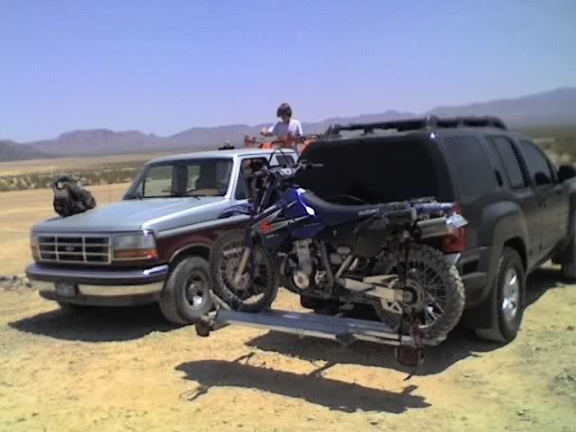

  • snowyrange
Posted 22 May 2012 - 09:23 PM
toadl, on 22 May 2012 - 05:46 PM, said:
You will need to have a full size SUV for one of these.  You are carrying your weight a lot farther out so you will need a higher tongue weight rating then 300lbs.  Something like a 4runner or GrandCherokee will really be sagging a lot in back and the handling will not be safe.
It is a lot easier to tow a bike with one of these and it won't really affect your gas mileage.
I would disagree.  Your fine with a mid-sized SUV (Xterra, 4Runner, Passport, Pathfinder, Jeep GrandCherokee, any 1/2 ton pickup)  Almost all hitches on these types of vehicles are Class III.  Most haulers you are talking about are for a class III or larger hitch.
I build mine based on the plans on this website. http://www.joehauler...s/JD-HAUL01.pdf
Made it out of aluminum mainly with some steel supporting structures.  The key is keeping the bike close to the vehicle.  You could never put a larger sized motorcycle on it...like my Royal Star.  A larger class IV hitch would be necessary.  As long as you have a Class III hitch you are good to go.
This old school Exploder is handling it fine...it's likely a heavier bike than a DRZ400 also.  I don't see any squating or unreasonable/unbalanced loads.
Edited by snowyrange, 22 May 2012 - 09:30 PM.

I totally agree Snowy,  I use the MX hauler with my Grand Cherokee.  No issues ever, beats using a trailer.

You guy's did see that I am towing mine on a stock suspended Xterra? I have no problems with it. The only thing I did was to mount a set of trailer lights to it so they could be seen better. :cry:

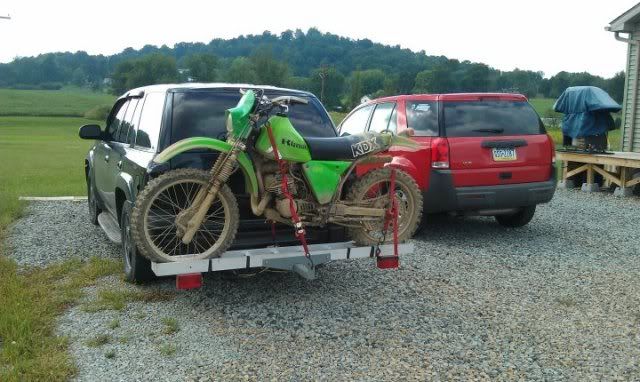

I have one I use on a 04 Chevy Trailblazer. It is much eaiser than towing my 14ft utility trailer for one bike. I also mounted a set of trailer lights on the back of the rack because the wheels blocked the taillights. Here is my old KDX straped to it.
