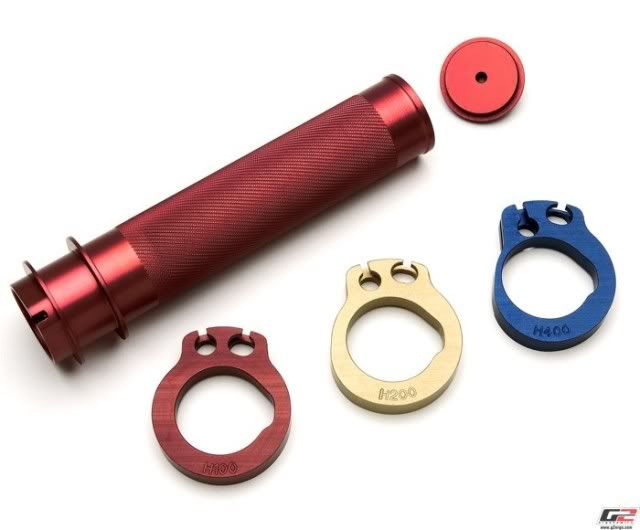

There is a large data base for jetting on the GasGas forums, you can tune for whatever you want. The Yamaha needles are known to be "peaky" and the Suzuki give you more "linear" power. You can use a throttle tamer from G2 to take the hit off the initial roll-on, too. Lots of ways to get the power you want.
  • ballisticexchris
Posted 23 May 2012 - 12:52 PM
Raise the needle one clip, go one up on the MJ, and get one of these:
A 2T is very easy to tune in/out power delivery with simple jetting. The G2 is a huge help as well. It worked really good for me. The cool thing about it is you can go right back to stock 1/4 turn if you don't like it.
