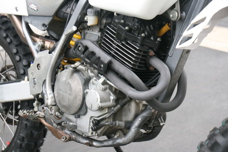

But our low tech, old tech, air cooled engines of the XR don't conform to "current engine manufacturing technology".

Exactly.  On a new vehicle I switch to synthetic on the 1st oil change @ 1000 miles.  Could do it the day you buy it but kind of a waste of money since you should still change the oil at 1k to remove any shavings worn off from the new engine.  Believe it or not this:
Does not equal this:
