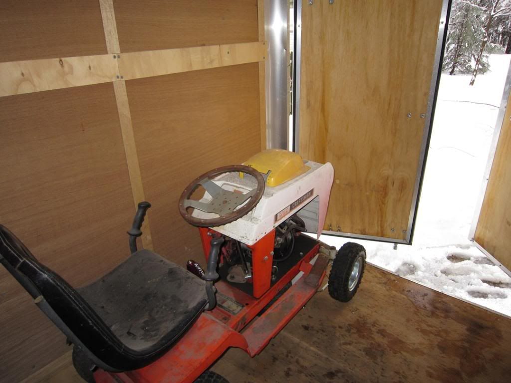

If I do not do this on my 250R I am DEFF doing this to my 1984 KDX80 engine that is in a miniature drag racing lawn mower, I do general riding with my LT so maybe changing the head is not a good idea but all I do is go in a straight line up a hill on the tractor so I'm sure there is more performance to be gained (it's geared really high now so I lost a lot of power which I can gain back with compression modifications since I can not fit a larger rear sprocket under the rear of the tractor).

To deal with high gearing you want the motor to make more power at lower rpm.
You do this by lowering the cylinder by leaving out the base gasket and just sealing it with tri-bond or Hylomar or Yamabond or what ever you normally use to seal cases. Extent the exhaust about an inch (if you are still using a tuned pipe) will help with low end power too. She will idle better too. Again, you have to make sure the piston to head distance is more than 1mm or 0.040".
