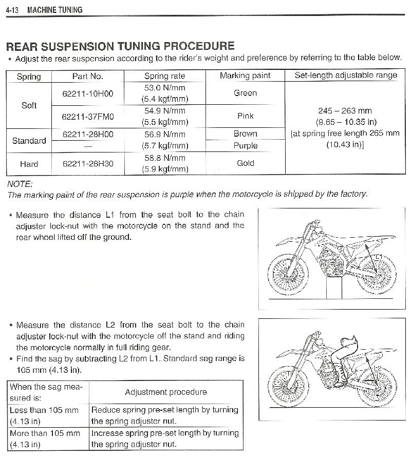

The rider of this bike is about 185 lbs and has approximately 18 hours on the bike. No attempt at any suspension changes had been made until yesterday.
The bike did seem to be hitting a little hard on landings, especially the front, and the rider complained of arm pump from vibration and shock thorugh the handlebars. Keep in mind, this rider is almost hopeless at describing what he likes or doesn't like about suspension settings.
First order of business was to check the sag. Book says 105mm, but his was around 70mm. The stock purple spring is installed.So we adjusted it for 105mm. It was way too soft. It appeared too soft, rear ride height was way too low, and rider complained he wasn't getting the air he wanted over jumps. So more adjustments were in order and he eventually felt comfortable with it set to about 85mm.
1/ My question is if this 85mm sag is common, or is he just so used to the old 70mm of sag, so he can't get his head wrapped around the recommended setting of 105mm?
And since I'm posting, I'll add that no changes have been made ot the rear shock, but we did play around with the front fork settings. Compression started stock at 11 clicks, trying 13 proved too soft, but he liked 12. (Personally I wonder if he can tell, but i have to go with his feedback regardless). Rebound, which is stock at 11, he seemed to prefer 10. He seems to like a little kick up of the front and doesn't like the mushy feeling of when the front wheel stays planted on the track (which seems confusing ot me, but i don't race).
2/ Bascially, I'm open to suggestions and would like to hear opinions and any recommendations on all suspension settings. Please include your weight though, so I have an idea of how to compare things.
Thank-you.
Thank-you.

I do agree that the rider needs to give the full 105mm sag a chance, but on the other hand, when he's on the bike, it does give it a nose up attitude. He was out today with it at 85mm, and came back happy. So he's getting used to it in the right direction anyway.
It really seems I'd have to do somehting to shorten the front forks with the rear spring set to 100mm of sag. Not sure what to do there... if anything.
As far as the spring colour goes, it actually appears more red than purple. If I had to call it a name, I'd say burgandy. But in the page below, you can see the stock spring is labelled as purple, and there is no red spring.
I am setting the sag as shown on the page below. Rider has some weight on pegs, and is sitting forward, almost to the gas tank. Maybe that is the trouble and he ought to sit back a bit.
Thanks for all the replies. Gives me lots to consider.

the color you are reading is the marking paint (a dab of paint on the spring which indicates its stiffness) and usually rubs off easily. the stock spring itself is red. get him to sit neutral on the bike (sorry about suggesting attack position as this is a far forward position) neutral basically means sitting in the middle of the seat with both feet on pegs (get someone to keep the bike balanced and not falling over as you do the measurements). what are your static sag measurements? get him to 100mm without telling him and get feedback. If he indeed is sitting too far forward during your measurements then maybe you are actually close as he sits more neutral on the bike (body position on bike can make quite the difference in measurements). is his weight 185lbs with or without gear? trust your manual and the guys on here when the say that 100mm is where you should be at. 85mm is going to make the bike unstable in the rough and break traction under hard acceleration. what is your riders level? beginner, novice, intermediate? what style of track are your guys on? (low speed with lots of jumps and rhythm sections "supercross", or long fast straights with rolling jumps and terrain "motocross") look forward to your reply...
Posted 15 May 2012 - 05:01 AM
Ahh... that explains the colour mystery. I'm sure it's the stock spring, as he's the 1st owner of the bike. And Yes, rider position may be the snafu here. We wern't sure, so he sat forward, up to the gas tank. I'll bet if he sits in a more trail-riding position, the sag will be a lot closer to 100mm. We'll test that tonight. Oh, and he was wearing his riding gear including helmet and boots for the sag adjustment. He's 185 in his shorts, so the gear adds some weight.

We checked tonight and when he sits around the middle of the seat, (a typical trail riding position), I get 90mm sag, which is closer to the recommended 105mm. From this, I know the adjustment for 105mm sag will not be nearly as soft as when I adjusted it before (rider sitting near fuel tank). So that seems to be most of the problem. The rest is likely him not being used to it.
The static sag surprised me. 35mm static. The 90mm we are presently adjusted for, is made up of this 35mm plus another 55mm once the rider climbs on board.

your static sag is about right (but this measurement is somewhat unreliable due to binding of the shock linkage/bearing) some get an average measurement by first lifting the rear of the bike and letting it drop slowly and take a first measurement. Then they will compress the shock and slowly let it release for the second measurement. averaging the two values is supposed to yield a more accurate static sag measurement. irregardless the more important measurement is your race sag, you dont have to go all the way to 105mm, you can try 95mm and see if that's the best compromise for him. (im of course assuming the measurements are being made with him in full gear). once the sag is setup up, it will be time to play with the clickers and fork height.
