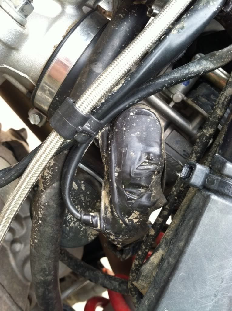

we all know to silicone the piece. But i wanted to share this...
I found this nitro tape from motion pro.. it is seriously some nasa shit. I highly recommend it. Im going to redo mine and make it neater, but you can see the idea....
note : you can wrap the connector too

Posted 13 May 2012 - 07:36 PM
I took some stuff from work that looks similar to that nitro tape.  We call it mastic, used to keep water out of a primary underground splice.  It stretches and is rubbery?
  • Officer Mike
Posted 14 May 2012 - 05:22 PM
yes this stretches and its siliconey. its similiar to electrical tape.. a bit thicker and not plasticy..

  • IAoffroader
Posted 24 May 2012 - 05:49 PM
We put the factory 2012 cover on our 2011 SXF 250 but this isn't an easy do-it-yourself option unless you are comfortable pulling wires out of the plug and then getting them back in the right slot + resetting the TPS.  The dealer had trouble with the plug after the wires were re-installed and had to order a new plug - am I really glad I didn't try this at home because I would probably still be trying to figure it out!  I've used this tape in our irrigation system and it works great underground so I'm sure that it will work fine for this application - I'm not sure how it looks though :-).

  • redrooster65
Posted 24 May 2012 - 07:46 PM
Then slice it open and zip tie it, still much more sano than mastic wadded around it
  • ckny
Posted 25 May 2012 - 02:24 AM
I slit the side of it and used goop to seal it up again, worked perfect for me.
