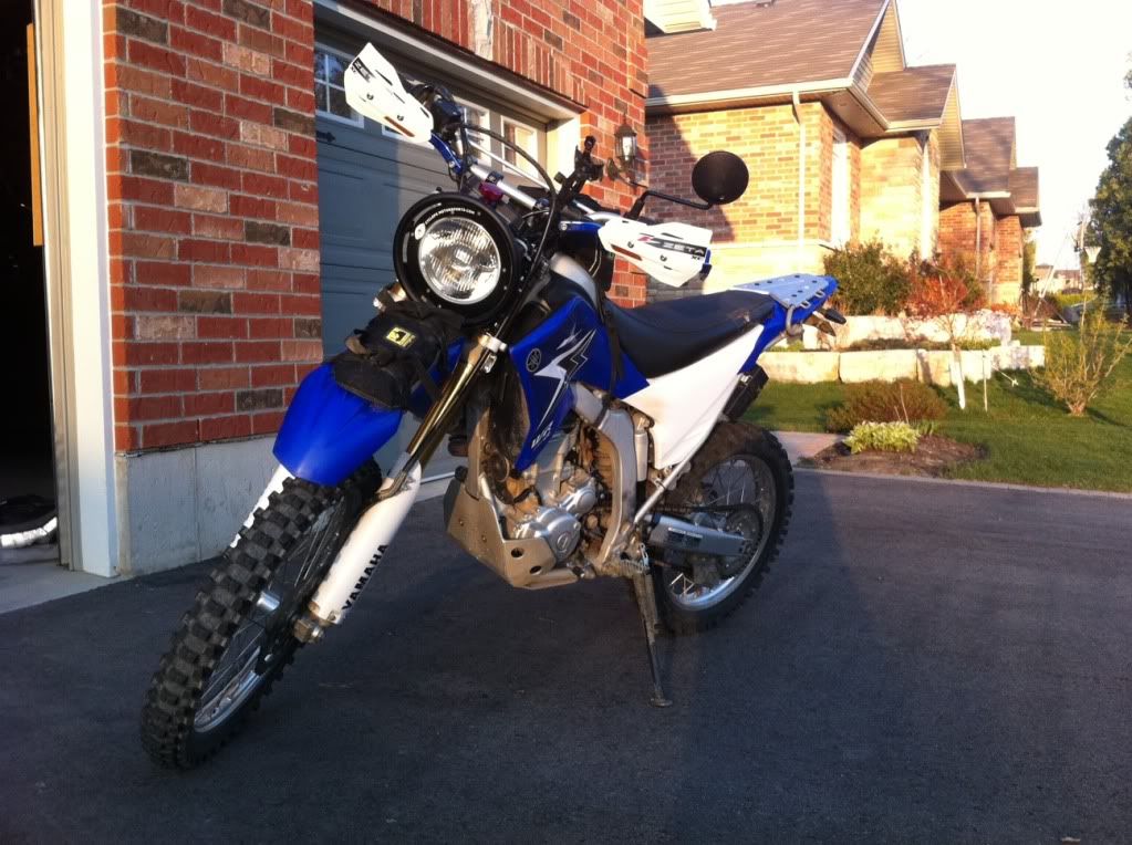

I live in Ontario, Canada.. the rules are similar to other places, we need the lights mirror horn DOT tires and a plate on the back.. I am in the midst of setting my 250x up for DS,
Pirelli MT-21 on the front and a Kenda trackmaster II on the back. quite knobby for the road but still work okay, and great in the dirt!
