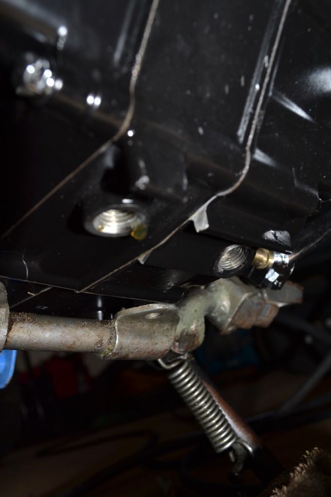

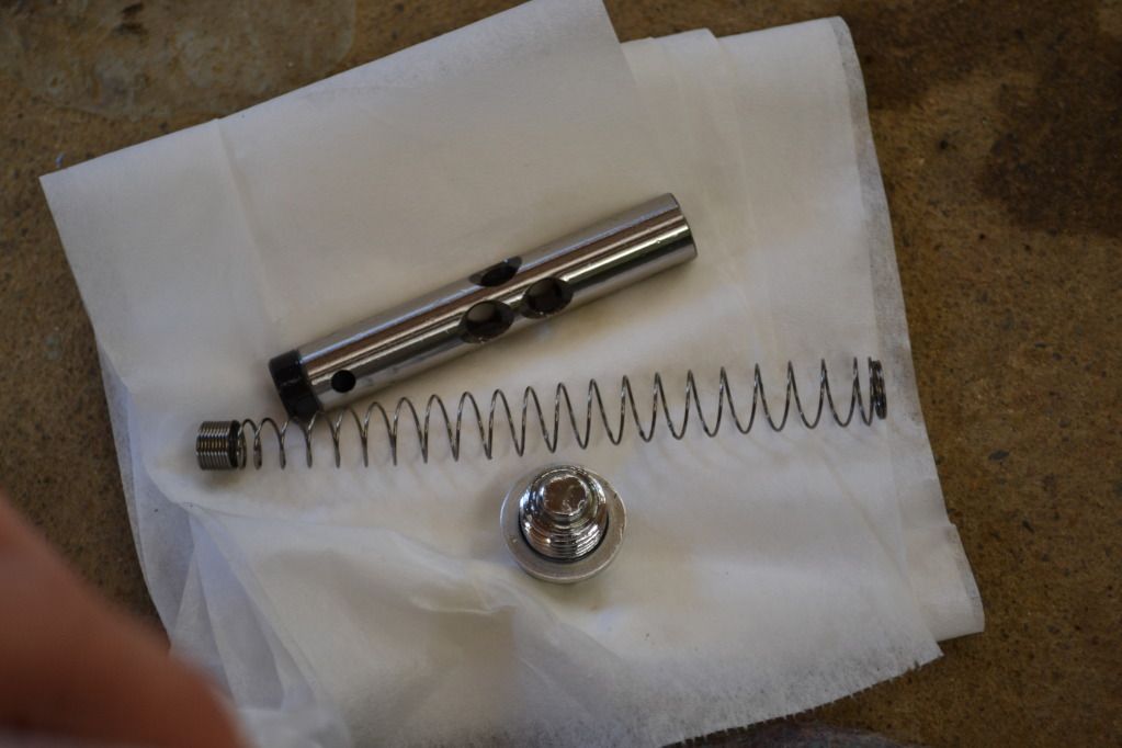

So I drained out the oil. There was around 1250cc's of oil in it. I assumed that both of the large bolts on the bottom were drain plugs.  One of them had some type of oil strainer come out of it and I'm not if I just shove it back in or it goes in a certain way because it had holes for the oil to flow through. Here's what it looks like along with the bolt that holds it in.
It came out of the hole on the right side of the picture which is on the left side of the bike.

Well apparently that is the cam chain tensioner, right? Can I just shove it back in and put the bolt on?
  • dirtbkr188
Posted 17 April 2012 - 12:20 PM
Yes, the piston goes in first, (black plastic tip end first), then the spring (small tight coiled end in first), and then the cap.
Note to self: No need to remove the cam chain tensioner assembly for an oil change.  Posted Image

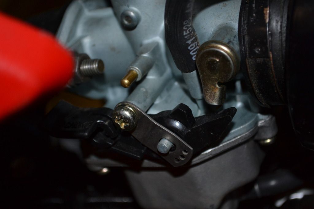

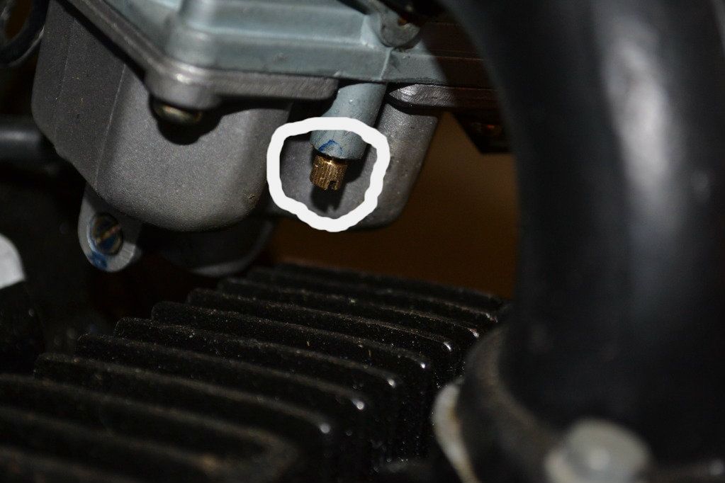

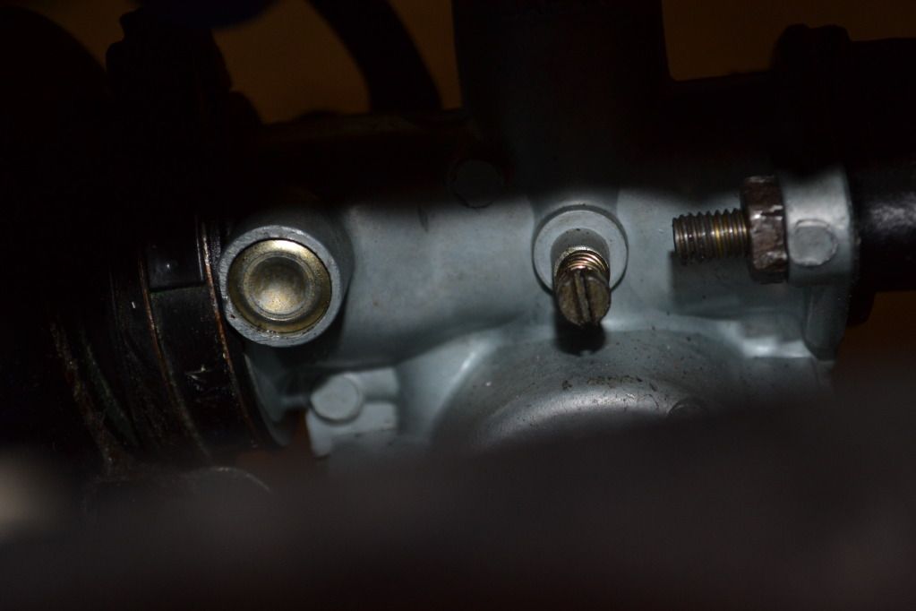

Here's is some more pictures of the carb.
I assume this is the fuel screw right?
What does this screw do?Posted Image
and just to clarify which way is choke? Posted Image

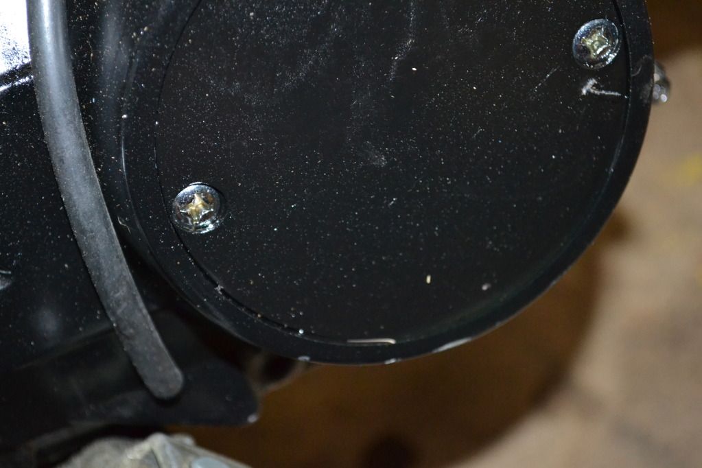

And here's where its leaking oil fromPosted Image

Pic1. Yes, that is the fuel screw, you turn it OUT to richen the mixture, and IN to lean it.
Pic2. That is the idle adjustment screw, to raise or lower the RPMs at idle.
Pic3. That should be choke is ON position. The small groove and slot on the choke handle is where you would attach a choke cable, and, pulling on the choke cable knob or lever would lift the arm up to put the choke ON. You can verify it by removing the airbox and looking at the butterfly plate in the carb.
Pic4. Should be the choke OFF position.
Pic5. There should be a big round gasket behind that clutch adjuster plate, or you could use a thin layer of YamaBond or ThreeBond 1194 to seal it and stop the oil leak.
