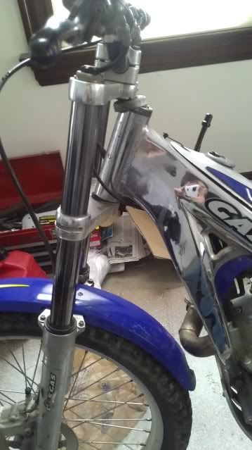

Anybody else snap a steering stem on a Gasgas TXT280?
Attempted to zap over a giant log and instead of placing the front tire just above center line it landed just under and rolled under then CRACK!  Knocked the wind out of me.  Will try and get some pics up later today.

Heres a pic.  If Im feeling frisky Ill tear it appart tonight and get some more photos of the breakage.

This type of failure is relatively uncommon on your bike. However, The front end can take some brutal hits and if there is any slop in the head set, the force leverage on the stem is high and can lead to fatigue and possible breakage over time. Keep the headset tight and watch the hard Zap fails!
FWIW: Your bike is one of the most reliable Trials bikes made and have long held a solid reputation as great starter bikes - but if ANY bike is neglected, you will see failures when stressed. (even MotoVita's beloved Honda 4rt :thumbsup: )

A failed ZAP like the one you described is not an every day thing. Not much different than running head on into a concrete wall at 15 MPH

One thing different if I remember correctly is that Dougie's stem broke at the bottom of the frame tube where this one broke at the top clamp..  I wonder if that indicates a loose steering head as Laser mentioned?

I didnt think it was THAT hard of a hit which is why I asked if this was common.  I mean I didnt fall over or drop the bike so to me it wasnt that hard of an impact.  Also I remember hitting trees with my supermoto and old trail bikes and going completly over the bars and not having any damage other than a brused ego.
I will keep a closer eye on steering slop.  I was playing in the yard a few days prior to riding Sunday and checking everything out on the bike and it didnt feel loose.  Just another thing to double check before going out.

Are you sure you cant just replace the stem and bearings? Any good machine shop would be able to perform this work.

After cleaning everything and a double check I think the triples are ok.  I dont see any cracking or bending.  Next step is to try and get the steering axle pressed out.  Lucky I have a band saw at work and a press in my basement.  Gotta cut the steering axle close to the bearing cause the bend in the shaft will cause problems trying to press it out of the lower triple.  Parts arent nearly as bad as I thought they were going to be especially if I dont have to buy the triple clamps.

Pressed out the broken steering stem from the lower triple and the triples are fine, got pricing for everything else I need from Lewisport.  Calling them Monday to place my order.  Figured $150 isnt too bad to reconnect the front end to the rest of the bike :thumbsup:
