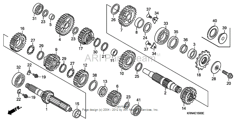

It's most likely your countershaft seal (part #35 below), which is an easy fix.  If you have the time, confirm that its actually coming from the seal by removing both the chain and sprocket and clean the area thoroughly with degreaser.  After it's been sitting over night check to see if the oil is coming from the countershaft seal. If it is the seal, remove the collar (part #3) and gently pry out the old seal and replace with a new one.  When removing the seal be careful not to damage the d-ring (#36) which will remain on the countershaft.

Ok- I've got everything open and the oil leak is coming from the counter shaft seal- how do I pull the collar off?
Pull it straight out using a pair of adjustable pliers. With the sprocket removed, the only thing holding it in is the lip of the seal.

I have the new Countershaft seal and I understand that I should be able to pull the collar out with pliers BUT so far the force required has eluded me. I have tried a pair of vice grips and channel locks and can't get it to budge.
2 things- Am I correct in identifying the two parts and second- If it's not budging should I try something else or is this another new issue?

Ok- I'm steps away from taking this to someone who knows what they're doing but I don't want to give up on myself just yet. I have the new Countershaft seal and I understand that I should be able to pull the collar out with pliers BUT so far the force required has eluded me. I have tried a pair of vice grips and channel locks and can't get it to budge. 2 things- Am I correct in identifying the two parts and second- If it's not budging should I try something else or is this another new issue? Thanks again for all the help... Here's a few more arrows...
Yep, those are the correct parts and it should pull right out.  Will the collar spin at all?  The collar just slips onto the output shaft, although there could be some corrosion between the two holding it on tight.

If you need that much force on the collar, I would recommend replacing it, and not worry about damaging it.  Also, I would replace both the seal AND the D-ring.  The D-ring is pretty inexpensive if memory serves me correctly.

He ended up having to die grind the collar to get some purchase on it and eventually got it free. There was a bit of a build up of grass in there but he was not really able to give me an answer as to why/how it would have ended up on there with such force.
At the end of the day he got it off, replaced all three parts (collar, and both seals) and the bike is running awesome. Been out on it a few times and no follow up issues at this time.
