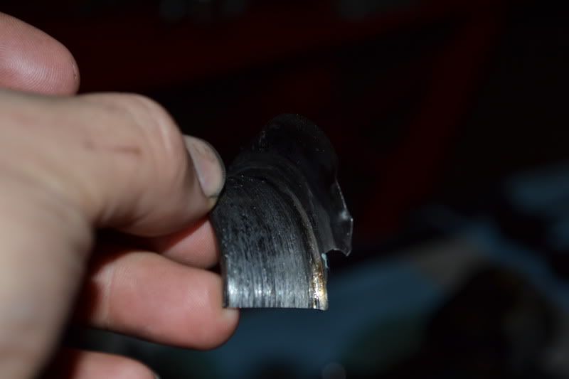

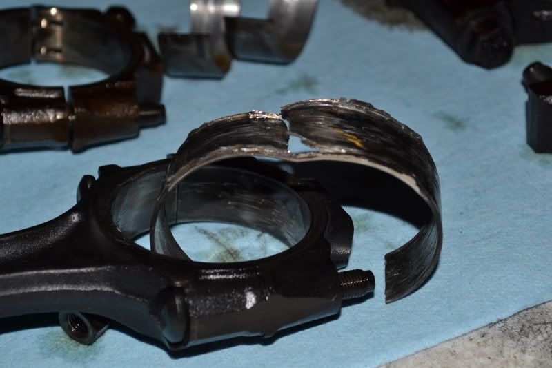

well my 3.0 ranger started knocking and loosing power so i toar the motor apart to find some really wasted rod bearings, one welded its self together and another grew a shoulder or something lol.

You run that thing out of oil or have a pump failure?
Old age?

Looks like it starved for oil or oil pressure was too low. Dont press those pins on yourself. It requires a rod heater. You could do it with a torch if careful, but they need to be centered etc. A machine chop charge is minimal and you can probably wait for it if they arent real busy.
ANy rod that had a spun bearing or was knocking, you need to get the end resized to make sure its round. Drop off your new pistons and rods, tell them to resize rids and hand the pistons for you.

yea i need two new rods. and i found out that my crank is cracked today also. so thers another 300 bucks

Before you go any further, how's the rest of the moving parts, all that metal went everywhere, not to mention the coolant in the oil,  camshaft, bearings , rockers, lifters. etc. it might be cheaper to get a reman shortblock. or even a longblock.
