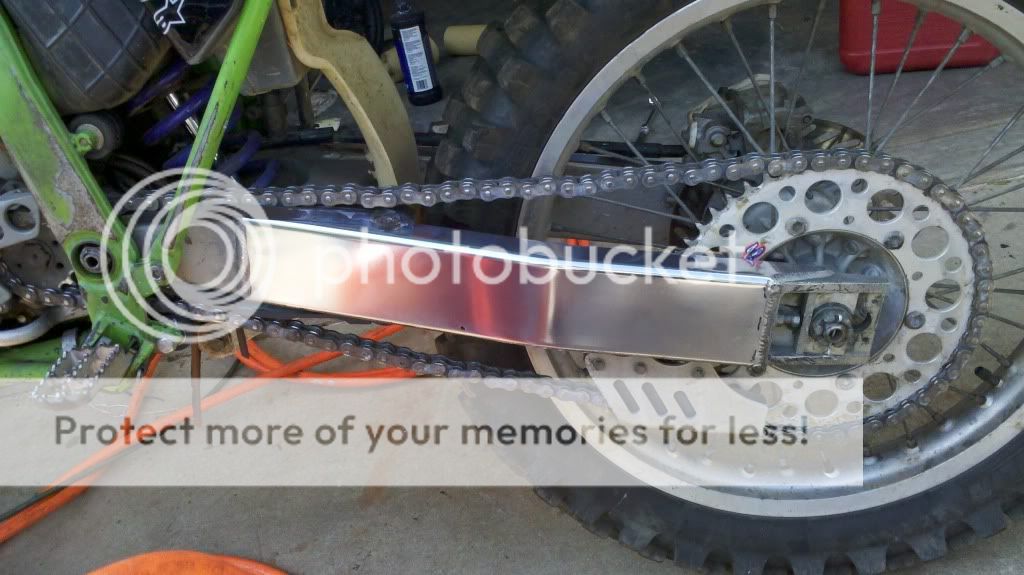

I did what Jeekinz did. sanded with 80 to get the paint off and then all the way up to 1500 (wet sanding when you get to the really fine paper) and then polished with mothers aluminum/mag polish. it works pretty good. i also repainted the inside cast section of mine silver, that part is just too hard to get at when the bike is togetther. This is a few weeks after i polished it and i had only ridden once, already needs to be touched up again with the polish:
looks pretty decent, i wasnt going for the bling bling mirror finish i just wanted it to look nice
