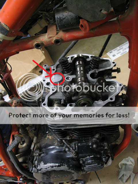

Well It turns out that It was not the gasket that was the problem it was missing a cylinder head bolt hole plug that was supposed to stop oil from leaking out. But luckily the part was in a box of parts that came with the bike. After installing I have no leaks at all.

Mine is always dribbling .... do you have a pict of that part.
you can remove the top with the engine in
  • evilmonkey77
Posted 18 July 2012 - 12:15 PM
This is the part that was missing on my bike and my bike is a 1984 model so you have to take the engine out in order to get at the top end unlike the 1985 which you can do top end work with the engine in frame.
