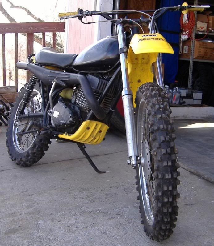

I recently bought a 72 dt250, ran for the guy I bought it from, took it home and had to clean the carb because it wouldn't start. Got that all cleaned up and it ran fine for like 30 mins. Stopped working thought i fouled out a plug so i replaced that and it starts up again. Well after about another 15 mins of running it stalls out and wont start up again, I tried replacing the plugs again and it wont start. I figured the ignition coil went bad and overheated until it melted the insulation in it. I checked the two small wires on the coil for resistance and Im getting none. Please help whatever you think it might be. I also need to know where i can find a coil for it because they stopped making them, I cant find anything that will work, is it possible to use a coil from another 250 that they still make?

Okay after much frustration...in working today I checked the compression which i should of done in the first place...getting about 30 psi cold...after putting a teaspoon of 10-w30 in there i got 60...which is leading me to believe it might be a piston ring...however...i think i figured out whats worse yet...the &%$#@! who sold me the bike has some very hidden white calk where the headgasket should be and at the base of the engine bowl. &%$#@! screwed me big time, cause I paid for a running bike...does anyone know if i can even get a headgasket and piston rings for this bike? I know this bike wasnt that popular and they stopped making alot of things for it. Should I be looking for a new engine now?
  • yellowsnow
Posted 12 March 2012 - 05:11 PM
Every 2 stroke that I had to rebuild a top end (piston rings) on stopped running when they get down to about 80psi.  30psi is so low that you may have damage. If they generally stop running when they get below 80psi. Then they don't have a chance to wear to a lower psi. See my train of thought on a holed piston or cylinder wall damage??
