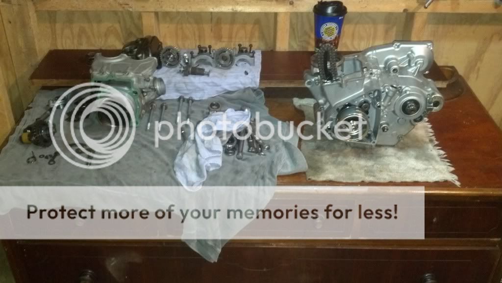

  • Blaker454
Posted March 24, 2012 - 07:05 PM
Finally found time for the bike... pulled the right side off and found that the kickstart shaft has alot of freeplay and that I had 2 teeth of a sprocket.... tearing more into it later
