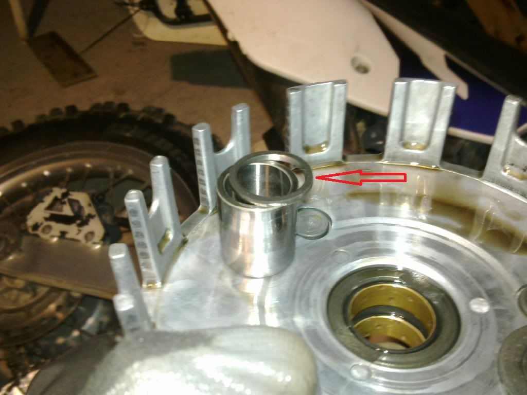

Hi again!
So today I decided to open the clutch, change the thrust washers and do a bit of clearance on the clutch basket!
When I had opened everything and was checking the things in there, it came to my mind to go check the clutch of my DR250S '91, to see if the parts were in better shape, to use some of them instead.
Well this is what I found out! the previous owner, one of the many, had used an extra washer, to create the clearance needed.
This is it, and where it must have been positioned
the washer measures 25x21x2 mm and creates a gap of 1.5mm approx, so the basket can turn without problems!
This is what it looks like
I have to say that I've never experienced any problems with the clutch of my DR250S
and now I believe that this washer is the reason! So I am thinking to use it with the 350 as well,
without doing any clearance at the basket.
I will only file down the notches in the fingers, put the new thrust washers, and install everything back!
What do you guys think? Any objections??
Thanks!
P.S. Thankfully the shift drum bolt was firmly in place!

Posted 14 March 2012 - 01:02 AM
If the washer definitely an extra to the DR250 clutch assembly, and it worked well, then I'd say go for it. You can always take it out again if it sounds/feels wrong.
Geoff

Posted 19 March 2012 - 12:05 AM
Well, here is how things went!
Saturday I finished doing the clutch maintenance job!
I filed down the notches from the fingers, I replaced the famous thrust washers
AND I installed the extra washer as mentioned above!
And it worked!!!
Yesterday I took it for an off road ride, quite hard for the bike, snow, trails, mud etc, and I am so impressed!
The shifting was smooth and neutral was so easy to find,
I do not know if and what will be the consequences in the long term.. I hope that there won't be any!
Since it was installed on the 250 for more than 2 years without any problems, I hope it won't create any at the 350 as well.
One thing I noticed is that the extra washer leaves a couple of less threads available for the clutch sleeve hub nut.
But I tightened it to the specific torque (60Nm) I locked it bending the lock washer, so I hope it will not create any problems!
Maybe it is early to call it a victory, but the initials results are encouraging!
I will let you know if something bad happens in the future!
