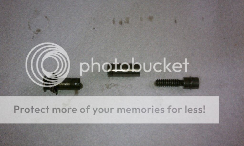

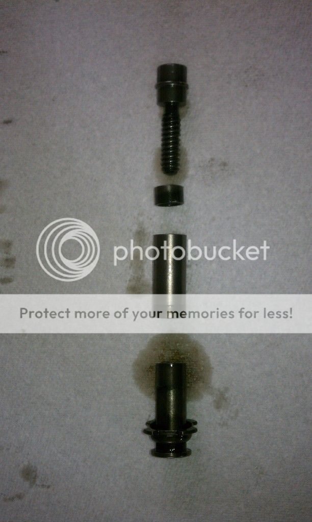

The spacer is now inside the mechanism. Below you will see that I unwound the mechanism almost all the way out.
This next pic is the inside of the housing that the mechanism goes into. You can see the cross section of the spring in the middle. Make sure you line up the groove that the screwdriver on the mechanism would go into with that part of the spring when assembling the two pieces.

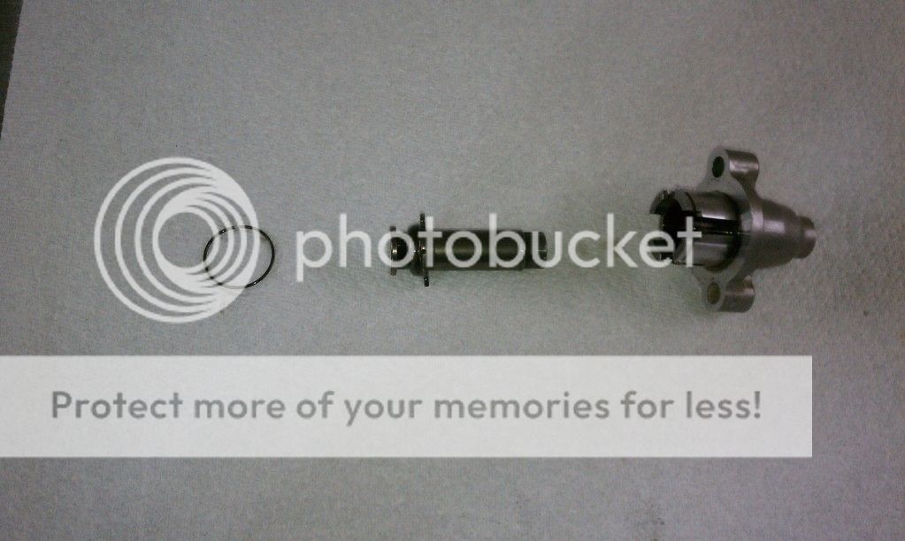

This next pic is the two pieces put together with the spring cross section in the flat head groove of the mechanism.
Next while holding the assembly together take a small flat head screw driver and turn the screw in until it locks the mechanism in the retracted position.
Last thing to do is install the small snap ring/circlip pictured here at the end of the housing.
Thats it! The timing chain doesnt end up as kinked up as quickly either though I still replace the timing chain every 40hrs when I do a piston just for cheap insurance and to not wear out the crank gear prematurly with a bad chain.
