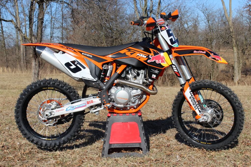

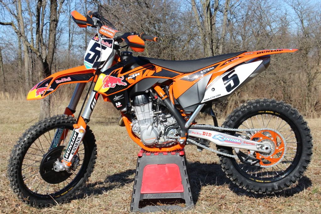

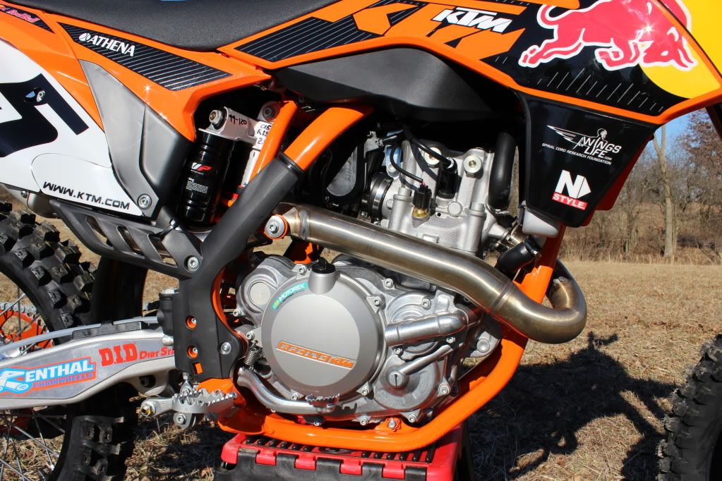

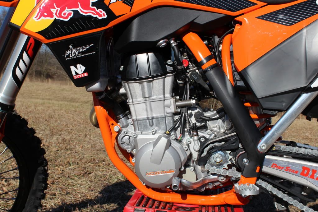

So I have now ridden my 450FE at a couple of different tracks and as the suspension has loosened up that too stiff valving I was feeling early on is starting to feel pretty good now, especially at speed...instills confidence to charge harder.  Not going to change anything other than clickers for now.  Still like light clutch pull effort and smooth engine power: really make this bike easy to ride....corners great and changes directions very easily and overall feels agile....a few pics from a recent ride....
