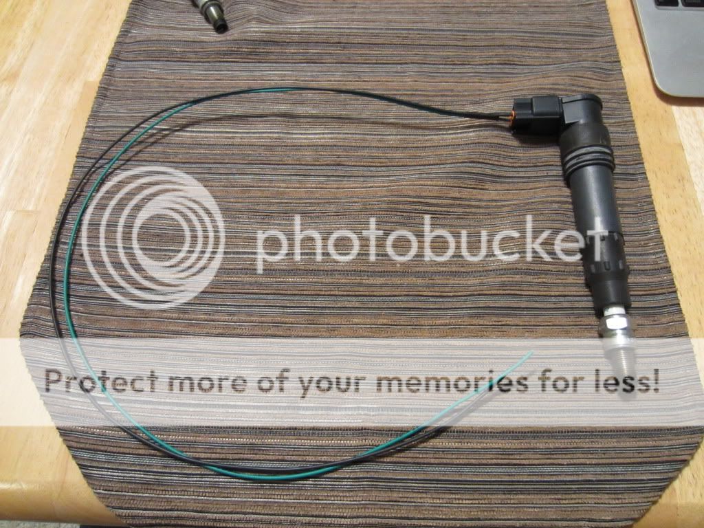

I'm sure this has been threaded to death but here I am anyways. After seeing serveral sites charging 70 bucks for this kit I decided to make my own. The research took a few days to track down what coil to use and what connector what not. I ended ordering 2 connectors and lone and behold only one worked. The other was supposed to be the updated version but yeah no dice. Either way I'm happy that one of the connectors (the original style) works fine. Here are a few pics of what I've done so far. Once I install it and wire it I'll share a few more pics.
supplies
almost done
done

  • yoterone
Posted 27 February 2012 - 06:58 PM
I sourced the COP on Ebay for about 15 dollars with a few dollars shipping. The COP connector I sourced off of this website http://www.corsa-tec...category_id=55Part number C2AS. The wiring I had on hand from my Megasquirt kit I got from diyautotune.com. I crimped the wires using standard automotive wire terminals. The COP is from a 99 GSXR 750. It fits really well. I slid down the seal to better fit the spark plug tunnel. A COP about 1/2 shorter would be ideal, but this one works fine.
