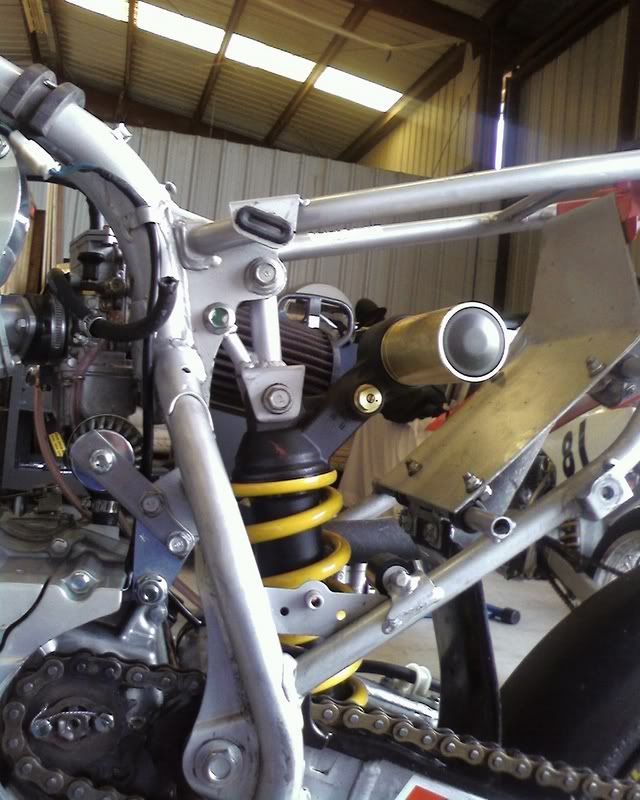

What other rebuildable rear shocks will fit the crf230f. Probably needs to be longer by about 1-2 inches also since I have the CR250 forks. Thanks
  • racejmac
Posted 14 February 2012 - 04:57 PM
I run a CBR 600rr shock... Wont work if you run the stock air box...

  • 230Fstroker
Posted 16 February 2012 - 02:57 PM

It's the same length as my stocker.  I don't recall the length of the CR85 shock, but I believe that's more than 15.4 inches.  To run the CR85 shock, you do have to do a few mods to make it fit.  People just don't mention that part.  Minor mods, but it won't just bolt on.  That's the only reason I picked up the XRshock.  It's the right length.

IM SHOCKED! its the same length AND it bolts right up. I Bought Tones XR650 shock back when this topic was hot and was skeptical when I received it. It just looked way big compared to the stock shock I had mounted on my 150.  So, like tone,  I put it aside.  Well today while working on my latest project I thought 'what the heck, it's all torn down, I'll check it out.... SWEEEEEET! Just have to find a local source to make me an extended remote reservoir hose and I'll be good to go. Thanks Tone.  BTW Tone, How's that yard coming along?
I'll post some pix when I get some time.
ST O.D.
  • SacTown Old Dude
Posted 03 November 2012 - 11:48 PM
Okay heres what I have come up with....looks like the mid 80s Honda CR125-500 had remote reservoir shocks.  The XR350s and 600s did as well. The XR350 reservoir hose appears to be longer in length than the rest. My shock appears to be an 86-87 XR600 unit with what is described as 3 way hydraulic preload adjustment, 14 way compression adjustment, and 4 way rebound adjustment. I can only attest to fit of the shock that I have.
ST O.D.
