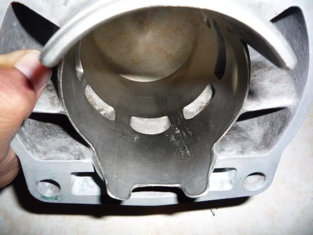

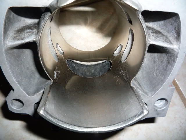

Posted 16 January 2012 - 12:29 PM
i'll take some pictures and post them for you guys to see
  • sinful
Posted 16 January 2012 - 03:07 PM
pics
  • gmoss357
Posted 16 January 2012 - 03:13 PM
I would try to clean up the jug and install a new piston and rings.  The scarring on the jug doesn't look like it penetrates the nikasil.  Nikasil is a heck of a lot harder than the metal in the piston and rings for a reason.

  • sinful
Posted 17 January 2012 - 12:17 PM
we did some cleaning on the cylinder but only managed to remove about 50 %.  we are doing some more cleaning as we speak.  although i think it might be pointless because it has a nick or small hole already.  you can see it on one of the pictures ( 9 of 10 ).  "unless the rings dont travel as far but i dont know that".

  • sinful
Posted 17 January 2012 - 09:39 PM
here are some pictures of the cleaned cylinder. finally after many hours of cleaning !
  • sinful
Posted 17 January 2012 - 09:47 PM
here are some closer pics
  • sinful
Posted 17 January 2012 - 09:48 PM
heres a pretty good pic
