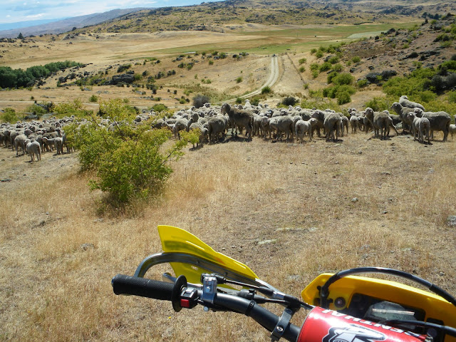

here are some pics of mustering the sheep, and the terrain we ride in.

Maybe I missed it but you guys don't wear helmets? At least that's what the pictures looked like.
Looks like a fun job, I would kill to do that for a week or so, it would be so fun!
  • farmernz
Posted 25 January 2012 - 09:00 AM
helmets are provided,not condoning wearing them but in summer it is very hot so sunhats are prefered, in winter wool hats, if they made a helmet that did both these jobs and weighed the same as a hat,and you could pull a rain coat over it - it would be great.
