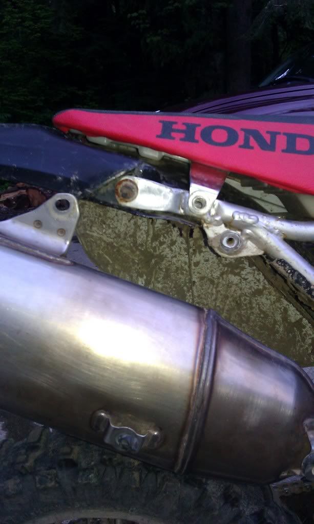

  • caryandreg
Posted 29 December 2011 - 07:57 AM
Edited by caryandreg, 29 December 2011 - 08:00 AM.
got my pic working
  • caryandreg
Posted 29 December 2011 - 08:02 AM
  • caryandreg
Posted 29 December 2011 - 08:05 AM
I had to build a bracket to connect the very last mounting point. it was pretty simple, everything else bolted right up. you will need to tweak the jetting as it changes the backpressure prfile in the carb significantly, it will bog off idle really badly if you dont.
plastics didnt fit perfectly, but they did fit well after one small mod.
plus you get the spark arrestor, I picked the SS muffler up off of ebay for 50$
cary

caryandreg said:
Hi Cary,
It does look good.  We will probably try one of these if we cannot get test results from anyone that has tried to quiet this bike down with off the shelf products.
How is the weight and the performance with this.  We have an R&D power bowel with a tuneable leak jet so we can probably dial out the bog.
We are thinking about an FMF Q4 (standard 96dB) or a Ti Power core with a 96dB Insert to see what keeps the sound low and power up.  Hopefully some has already tried this with a slightly modded motor (HC piston and slight porting).
Nick

  • weantright
Posted 20 March 2012 - 04:50 AM
View PostBethumped, on 01 January 2012 - 12:27 PM, said:
Hi Cary,
Nick
Weight wise it's almost double. Power wise it's a big loss even after the jetting change. Great for a trail bike but for racing there's better options. Power wise nothing beats the stocker
