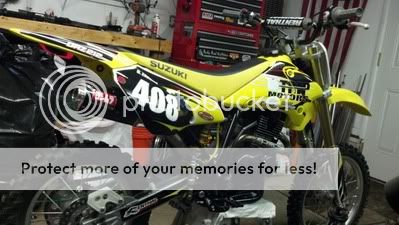

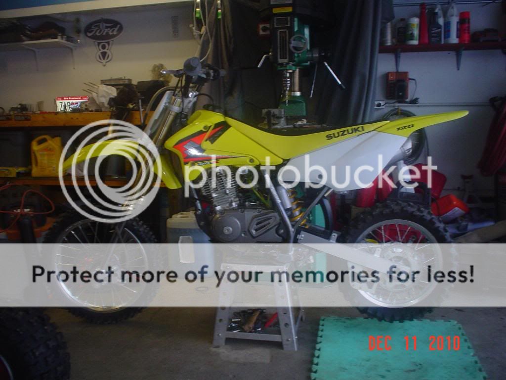

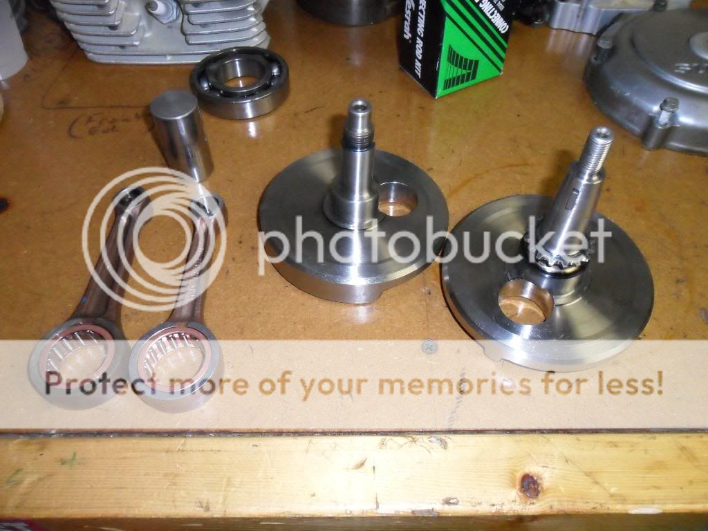

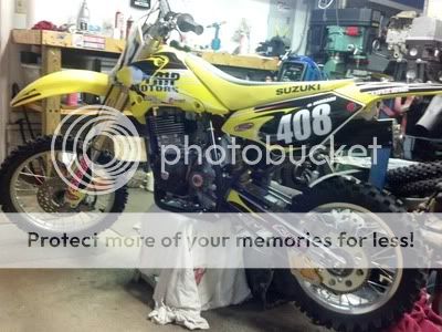

I documented this over on another site and have recently fifnished the bike. I figured I would share it over here on TT. I'll post pics and specs and what I did to get to 212cc's over the next day or so.
  • dougtrip

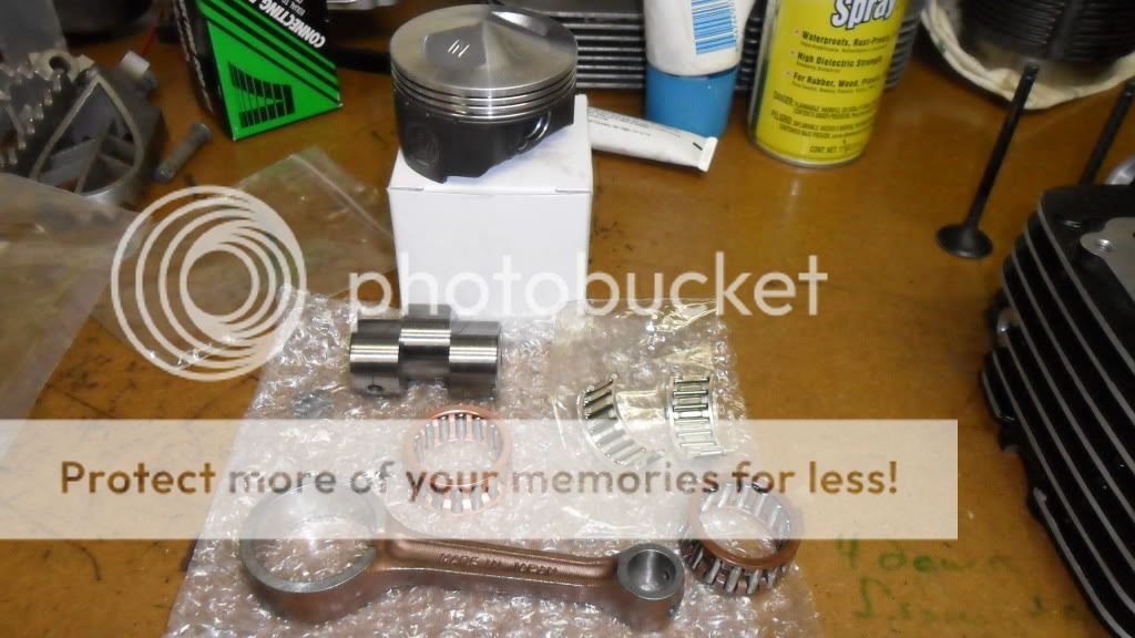

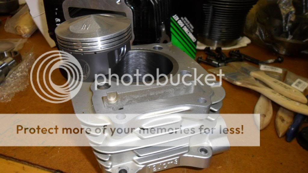

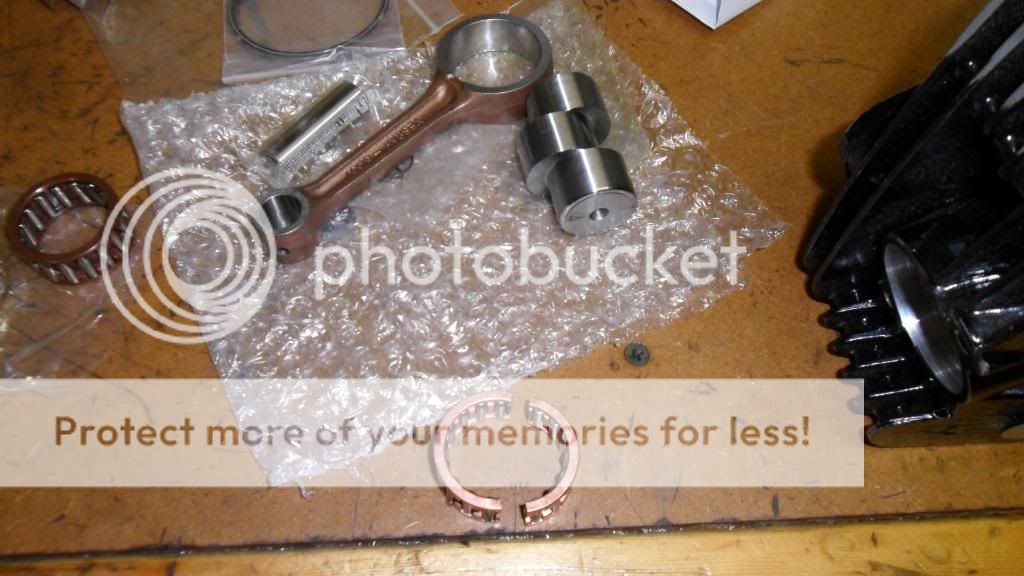

Posted 14 November 2011 - 07:14 AM

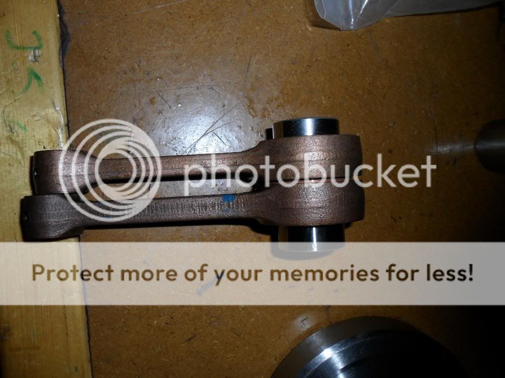

65.5mm piston, shorter lt160 rod, stroker pin
I couldn't find a split bearing that was the correct size for the big end of the rod so i had to make my own from two seperate bearings.

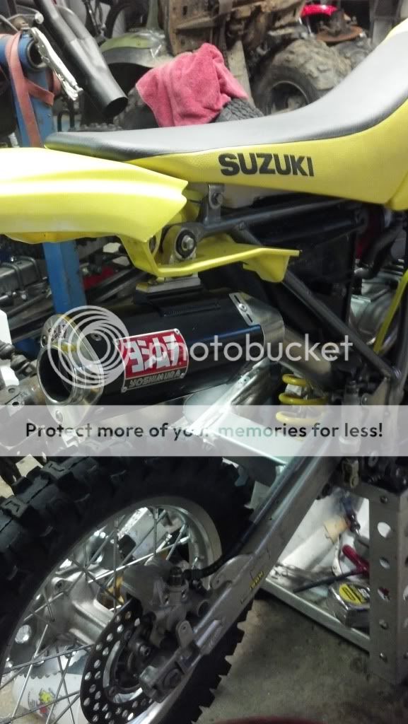

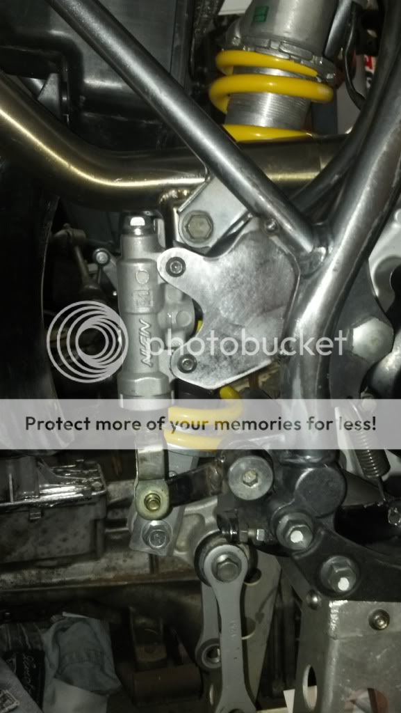

  • dougtrip
Posted 14 November 2011 - 09:57 AM

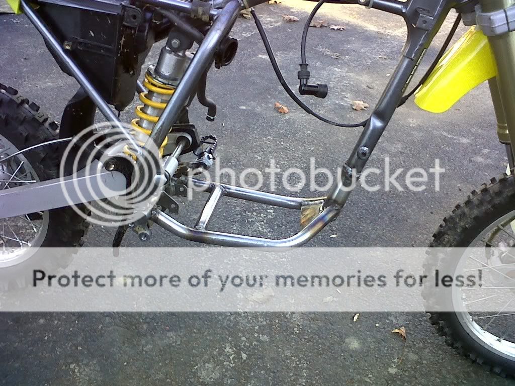

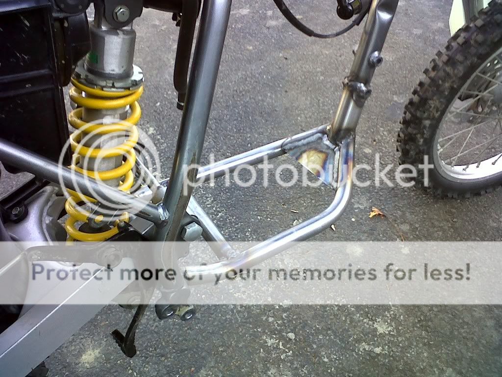

  • dougtrip

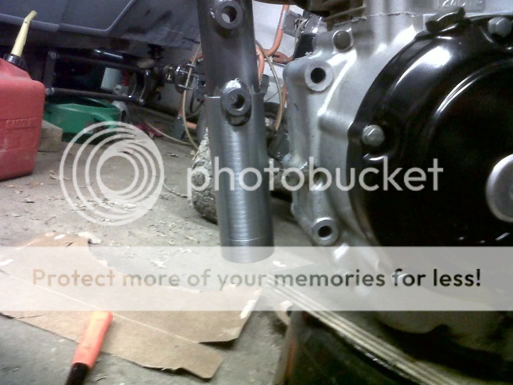

Posted 14 November 2011 - 10:01 AM
twowheeltom had made mnervouse about breaking cases so i added a frame cradle to stiffin everything up
