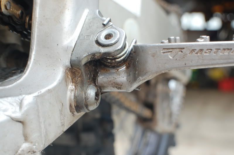

On an '06 cutting and dropping the stock pegs make the peg stop hit the bracket mounting bolt. Fastway makes lowered peg mnts and lowered pegs, but I could not remove my peg mounts they have very shallow torx bolts. I mounted the Fastway pegs, tightened the adjustment bolt in all the way and ground down the stop to hit the mounting bolt head and obtain the correct peg angle, has been working great for 2 years. I'm 6'3" and also have a tall seat and bar mnts raised 19mm and Windham bend ProTapers.
