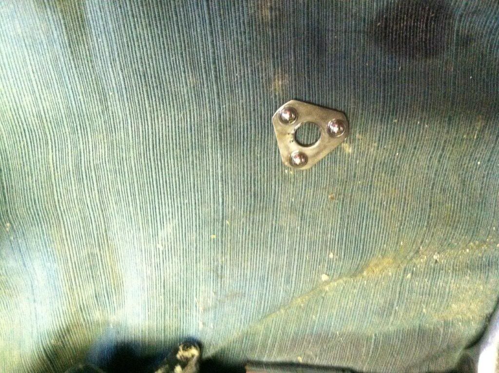

Posted 13 June 2012 - 12:17 PM
ok finally got around to taking cover off after trying to adjust the side cover bolt/nut. So I took the cover off and don't really see any issues but got some pics maybe you guys will see something I am missing.
This little piece was laying in the bottom but it doesn't seem to attach to anything so it most likely fell down when pulling the cover off.
