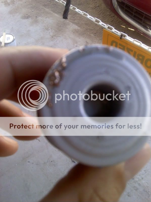

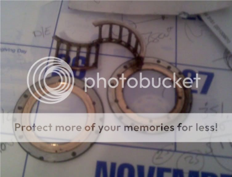

  • AdamRm
Posted 03 August 2011 - 06:10 PM
3 out of 4 -2010 crf250r at are local track have all had crank problem.One was owned by a honda motorcycle mechanic,other had 45 hours,my practice crf had 100 hours when i found this @pic, in my case i was luck to find out before any real damage happend,i'm at 45 hours on my race crf with no sign of damage
