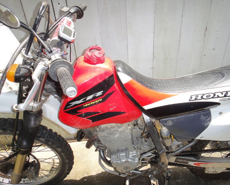

Here's what my bike looked like with the red 400 tank mounted.

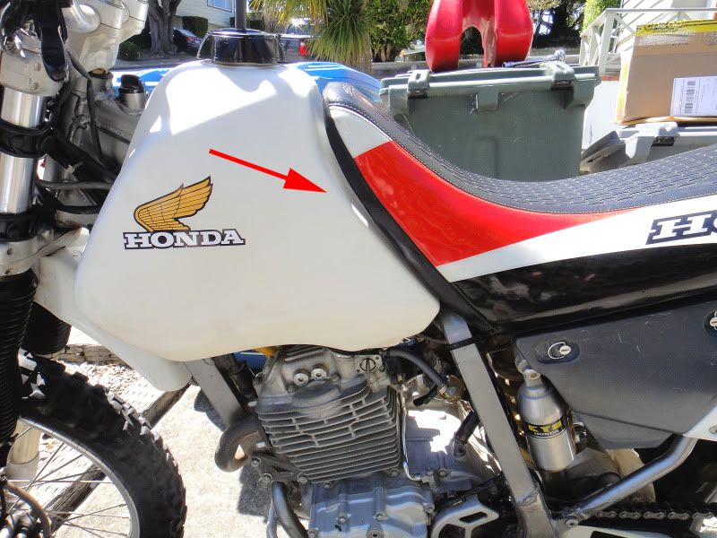

Here is how it finally ended up, with the white 400 tank mounted.

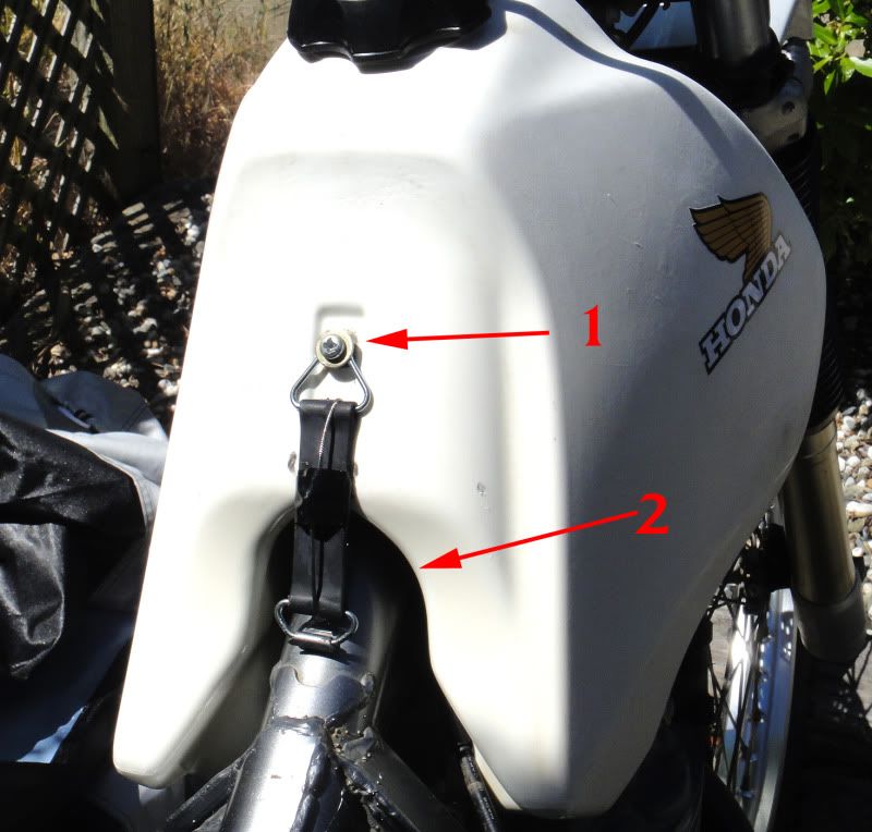

When I tried to use the "collar" on the white tank, the seat would not lock into the collar (# 1) and the rubber of the retention band was very tight (# 2). It would have worked, but I thought I could improve on it:
The seat recess fit very well on to the "mushroom" on the back of the stay so I decided to use it instead of the collar. The stay bolted right on to the tank and fit into the recess molded into the tank. I liked the stay but the band seemed a little too loose:
On both the red and white 400 tanks, I tried the 250 forward mounting hardware and they bolted right up to the tanks. The forward mounting plates (PN 17522-KCE-670) are the same on both the 1999 250 and 400. The front of the tank mounts perfectly to the attachment points on the frame:

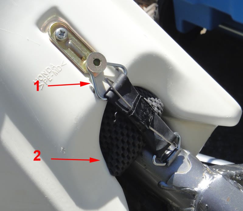

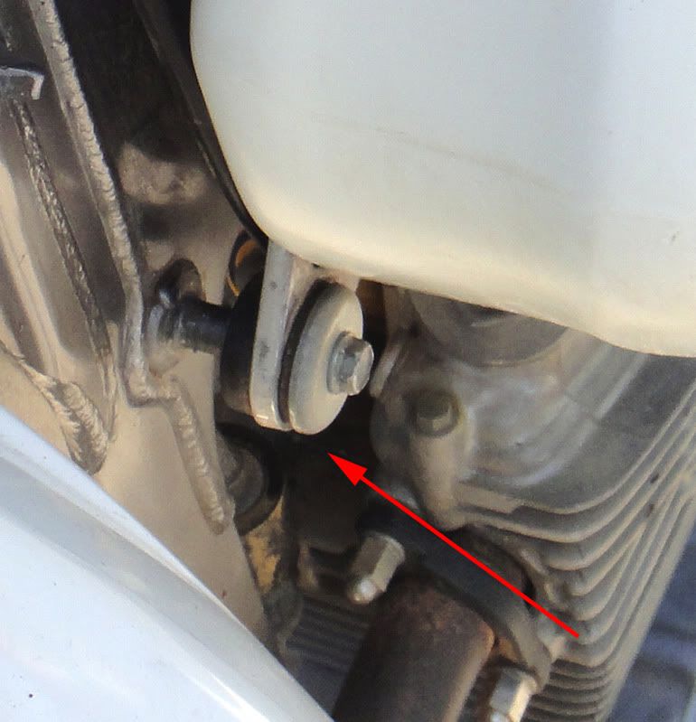

With the front of the tank firmly mounted to the frame and sitting on the XR250R's rubber tank bumpers I noticed the bottom of the petcock was very close to the top of the engine. The 250 and 400 use very different rubber mounting bumpers between the tank and the frame. I took some rubber and padded the area between the top of the frame and the tank. This tightened up the retention band (# 1), cushioned the area between tank and frame (# 2) and moved the petcock well clear of the engine:

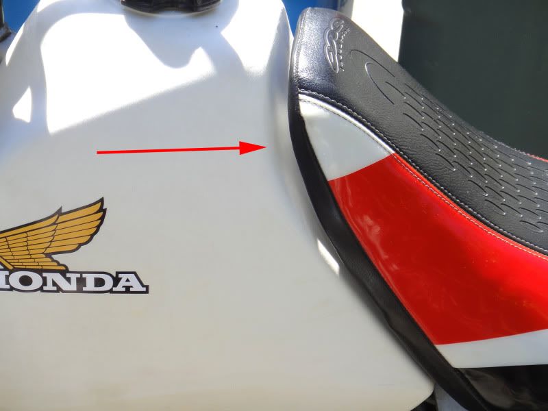

Is it a perfect fit? No, there is a slight gap between the tank and seat front:
http://img.photobuck...torial/Gap1.jpg
However, the gap is not that noticeable IMHO and everything seems tight and secure:
http://img.photobuck...torial/Gap2.jpg
So, I would say that the 400 tank fits fine and is secure as shown. I can live with the gap. If a 1996+ XR250R tank became available at a great price I might consider getting it but I can't see that it would be a huge improvement over what I have.
