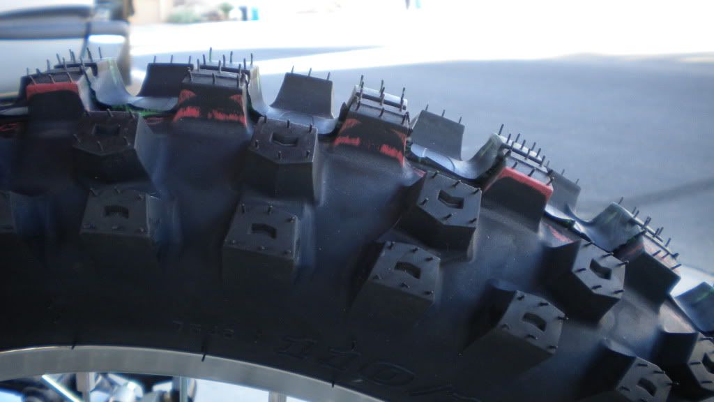

Rode some single track again yesterday with some friends. I was out front because they were riding dual sport 650's with big gas tanks (and probably less than optimum tires.):)
Got a chance to ride fast, taking a lot of hard, sharp hits to front and rear and making quick turns. I'm getting faster on the 450, partly because the bike has been tuned for these type trails and I think I'm becoming more experienced with the 450.;)
However...the MAXXIS Desert IT rear tire has been getting worn and losing traction. It has about 250 rocky miles on it. I decided to drop the pressure from 14 psi to 11 psi. The tire didn't have any better traction and I got a flat within 30 min.:)
I rode the rear flat back to my truck (~4 mi). The two rear rim locks worked. Later in my garage, when I pulled the tube out, I could see impressions of the two rim locks in the tube. I put some air in the tube and noticed leaks in a couple of spots with small punctures opposite the rim locks. When I looked at the rim locks (Motion Pro's new lightweight plastic) There were some sharp edges at the spots that lined up with the tube punctures. I ground down the sharp edges of the rim locks before reinstalling them. I couldn't find anything that punctured the tire.
Used a new rim strip with a new IRC Heavy tube. They're cheaper than the other brand of HD tube Iv'e been using and weigh a little more (2lb 10.5oz), so I guess its a little thicker?
Put the tire back on but flipped it around to use the "sharp" edge of the knobbies.:)
Went riding again this morning and the tire hooked up much better. Pounded the tires pretty hard without any flat issues.:)

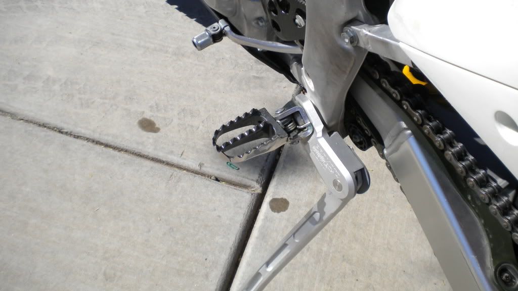

Installed the ProMoto Kickit Billet Kickstand. It looks nice but I am disappointed with it's weight. It's only a 0.25lb lighter than stock!!! :foul:Also, the bike stands up more vertical than with the stock kickstand which makes it feel less stable on uneven ground.

I added some new footpegs to the 450X. I chose the IMS Pro footpegs. Dirt Rider Magazine did a comparison in the Oct 2011 issue. They are 50 mm wide, a medium width. Wider than the stock pegs, but not as wide as some of the 60mm "platforms". The look great! The stainless steel has a polished finish on the outside and the rest of the peg has a gray powder coat. The stock pegs were too narrow for me an looked cheap, cheap, cheap!!:worthy:
Unfortunately, they added another 0.25 lbs to the bike.:worthy:

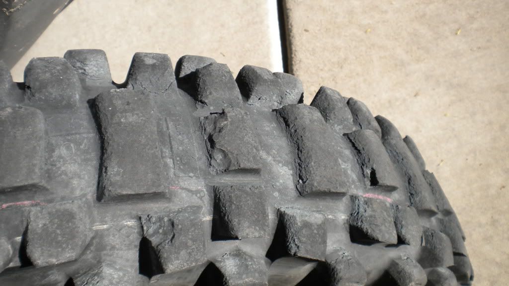

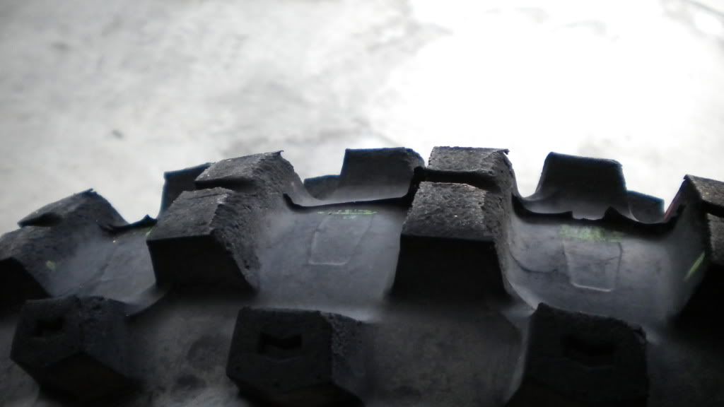

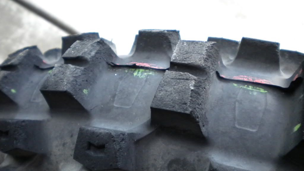

Rear MAXXIS Desert IT has run it's last lap. It's pretty worn and is chunking. It weighed about 14.5 lb when new (110/100-18), and now weighs about 13.0 - 13.5 lb. Totaled up my ride log. Looks like I got about 425 miles on it. Looks like I installed it mid-August. Had about 18 rides since then, averaged about 24 mi per ride.:busted:
Installed a new Dunlop MX51. New tire weighs about 13.5 lb. It's a full 1.0 lb lighter than the MAXXIS. Can't wait to ride it this weekend. Nothing better than new tires. Bet this baby hooks up well.:busted:
Probably won't last long. Knob pattern isn't very dense. Not sure what tire I'll try next.

Sofiedog went for a 15 mile ride through granite infested trails this morning. Sofiedog inspects brand new MX51 with one ride's use on it:
Sofiedog says "That bites!!!" This MX51 may be a great MX tire for those MX wussy's, but it won't last a month out here where the real dogs ride.
Got the bike washed. Need to order a new rear tire. What should I try next? I can get a Dunlop D739AT for 88.99 at Motorcycle Superstore. They also have a pretty beefy looking Bridgestone M22 Hard Terrain tire for only 63.99
