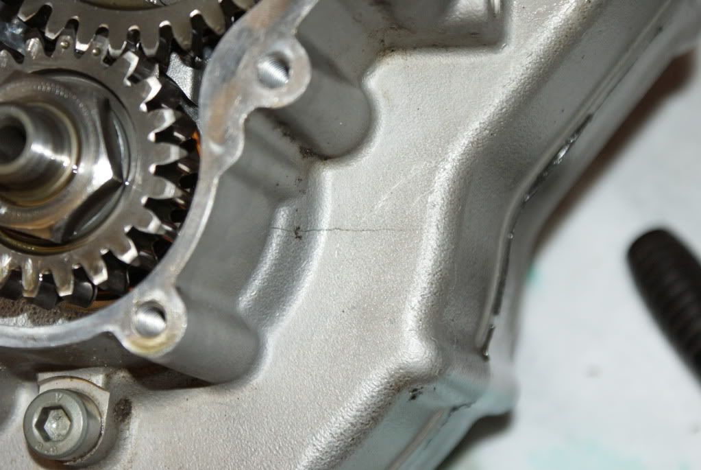

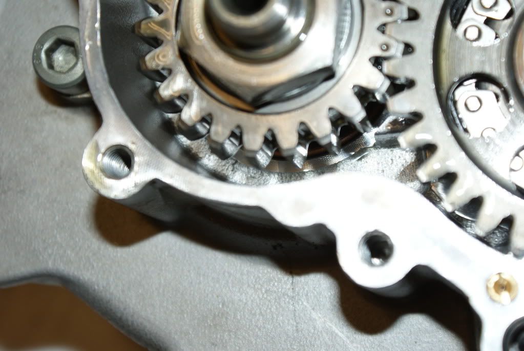

So, I found a crack from my SXF250 07 crank case. Cant find any info about the alloy.. is it aluminium? magnesium? aluminum-magnesium? Is it possible to weld? I know a guy who is a specialist on tig welding. But what do you guys think about these pics. Can it be done? Or.. should I just scrap the engine? Is there any problems to install a 08 or 09 engine on 2007 frame?

Looks like an easy fix for a good tig welder. I believe the cases are cast aluminum.

If its cracked from the bore where the shaft goes through, I doubt welding would do much good.
Looks like metal fatigue, time and revs have taken their toll. 06 to 10 will go straight into the frame. EXC, SXF or XCF.

I'd try having welded. I've had some worn cases welded and they held fine. Sometimes for cracks, they will bore/grind into the crack and then weld it up. Take it in to a machine shop and just let them give you their opinion.

Im just in doubt because you can see that the crack goes to the crankshaft bearing. But I hope they can machine it again after welding so that the bearing goes like it should. The guy who I know. who knows TIG welding. Is a owner of a machine shop. He should know this type of stuff.

Machine engineer said that get new engine case. TIG welding in that place would ruin the case. And would be a big job. ..and he has so much work that he could do it in August. But.. he told me to take the crankshaft to a other machine shop and see that it is ok and in balance. Change the crank bearings and try Techno Weld. It could work and stop the oil leak and fracture. Cant do any more damage any more. Now I have done some praciticing on the Techno Weld, and reading everything about welding of aluminum.
My possibilities at the moment: Make a big ashtray from the engine case. Pay some money to welder/machinist to try TIG-weld it and possibly ruin it. Or.. use this wierd Techno Weld and try it myself. I have done gas welding before and this is very much like welding colmonoy on a steel shoe. I shall take my chances on this! If I fail.. I still have a chance with TIG.
