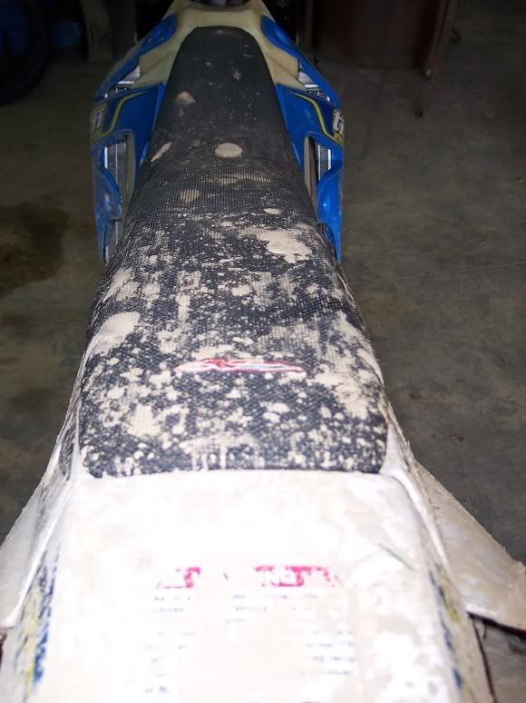

I had shaved the seat and contoured it to my liking and added an N-style gripper cover.

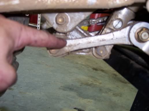

I run 120mm of sag.I also made a small linkage modification. It didn't make a huge difference,but complimented my suspension setup and way I ride.

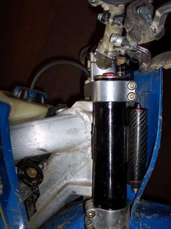

I run air chambers on the front forks.It is an easy way to adjust the fork oil/air volume in the outer chamber and gives more plush in initial stroke.

here is seat
linkage mod
tank mod and sub tanks for forks
